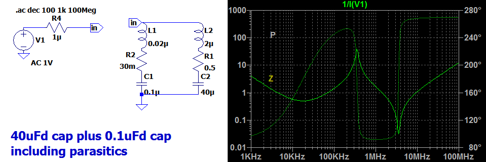

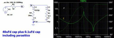

That 'high end' article is daft. Given the parallel film caps what he may be hearing is the effect of resonance, which will be worse with low ESR electrolytics. The article is basically ignorance parading around and calling itself a deeper form of knowledge.
I have a scrap image of "parallel caps" including some parasitics.
The 40uFd alone would fall to 0.5r at the top of the audio band and rise slow above 1MHz.
"40u+0.1" shows a violent rise near 330kHz. Whether that matters or not requires much study of the system PSRR and how it intermodulates supersonics down to the audio band.
And yes, if the 40u cap was lower ESR that 330kHz peak would be even wickeder.
