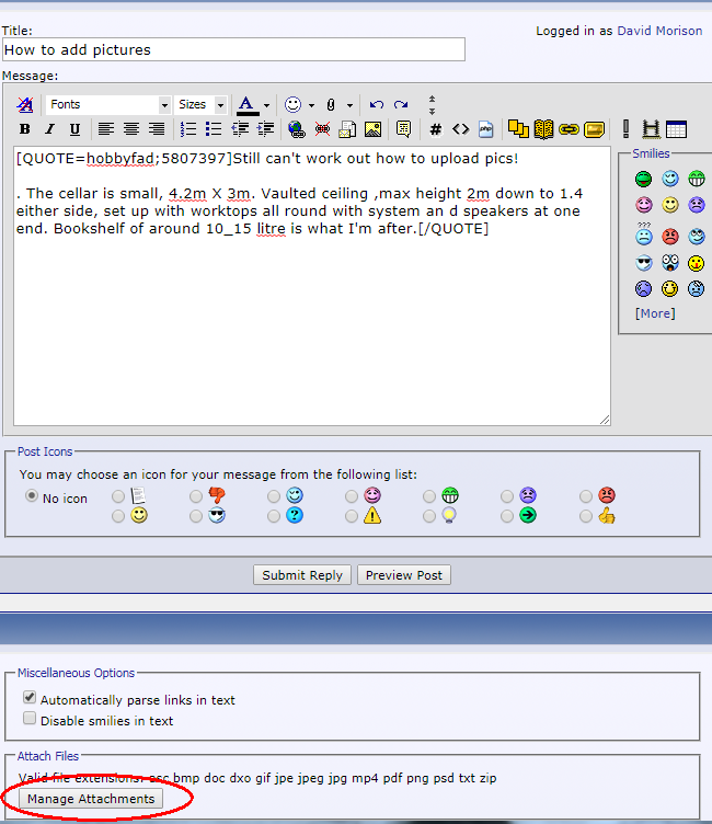

Still can't work out how to upload pics!
. The cellar is small, 4.2m X 3m. Vaulted ceiling ,max height 2m down to 1.4 either side, set up with worktops all round with system an d speakers at one end. Bookshelf of around 10_15 litre is what I'm after.
How to add pictures
Use the Manage Attachments button as highlighted below...

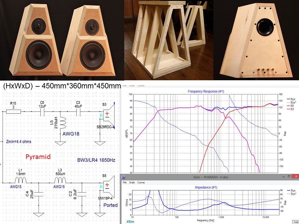

The Seas Trym in your original post is 34 liters. Also very expensive relative to other good choices.
At 15 liters look at Jeff Bagby's Mandolin and Adelphos kits.
SB_Acoustics' high end Satori drivers get great reviews.
World Expert Joachim Gerhard created the Kalasan as an open design for SB-Acoustics Satori drivers. The $52 SB29RDC-4 tweeter measures almost identical to the $132 Satori TW29R-4 tweeter used in Kalasan.
SB Acoustics Satori Monitor - diyAudio
Joachim Gerhard final Satori Kalasan crossover 5.0 circuits from the Kalasan diyAudio thread. # 700
--SB Acoustics Satori Monitor
measurements post# 699
crossover circuits post# 700
photos post# 801 762 746

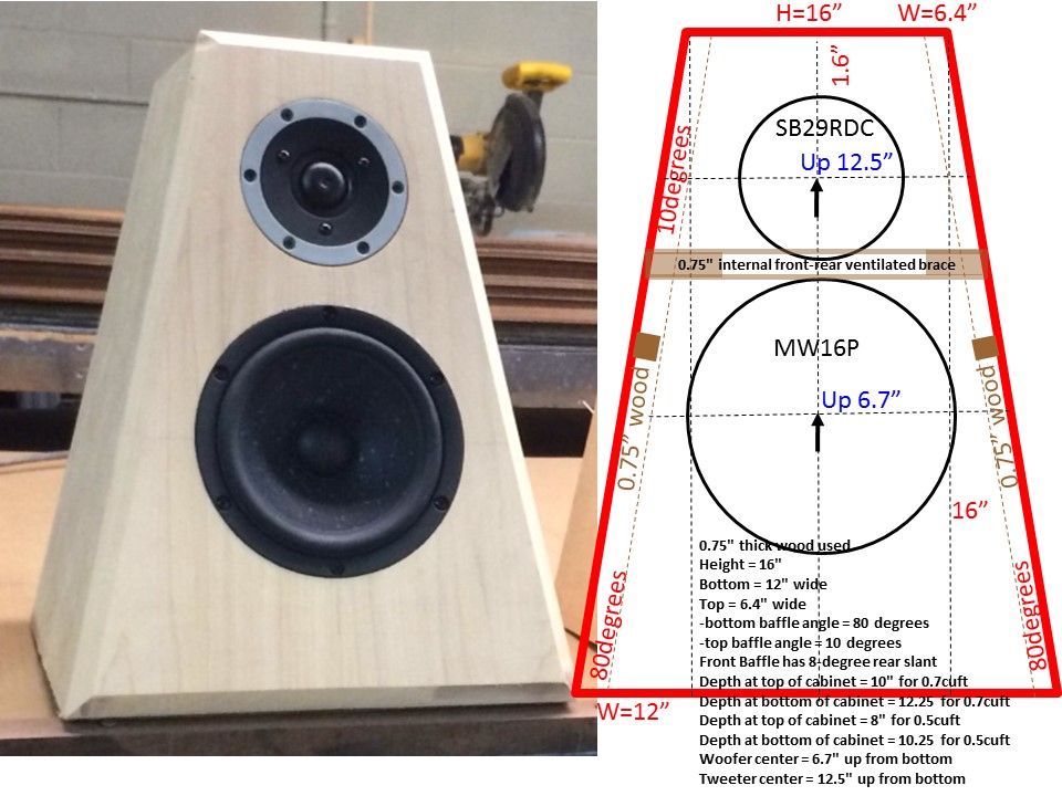

The woodshop capability often sets the design selection.
There are two common 15-liter cabinets with slanted baffles for time and phase alignment: box with 6-degree slanted baffle; pyramid shape with slanted baffle.
My desk speakers use the 7" Satori MW19-4 midbass with the 1.1" SB29RDC-4 tweeter using a 1650Hz crossover. Very natural vocals.
