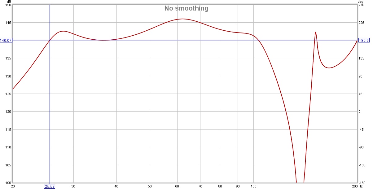

B&C 18IPAL works very good with switched car audio amps like the Soundigital 5000.1 EVO.
The best part is that you don't need so many drivers when running B&C 18IPAL in a HROAR (8th order mixed Helmholtz and Quarter wave bandpass box) with 5 kw of power to each one. 😉
Add 6 dBs to the graph below 60 hz for cabin gain. One B&C 18IPAL in a HROAR with 2200 watts.
