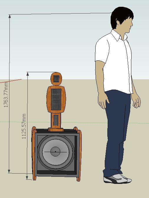

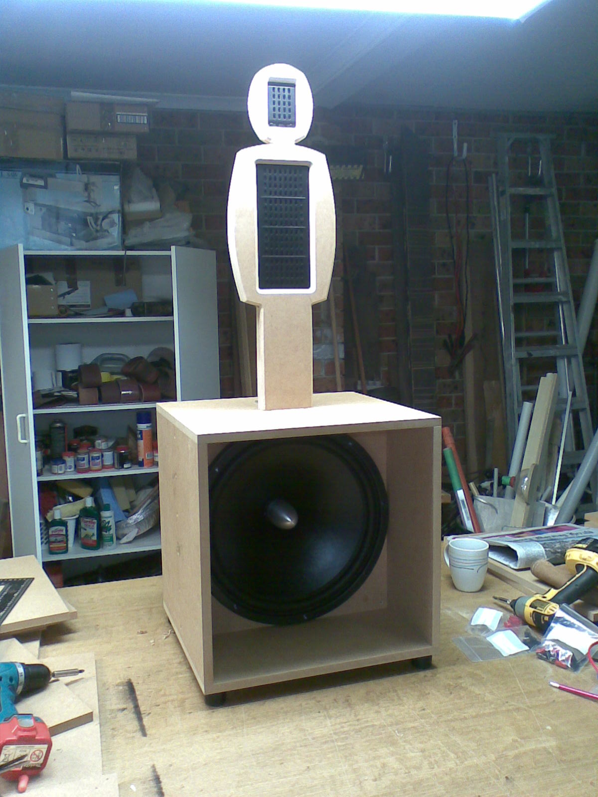

Yep, I know, that's why I tried to come up with a baffle that's only a bit wider than the driver 🙂 It's not the baffle width that's the issue, it's the depth of that small 'roundover' on the front, I think. I think I'm getting a reflection off that edge. I've tried the driver nude, and that works fine, but of course looks kinda ugly.
I don't seem to have the null with my tweeters & all I've got at this stage is a 45 degree chamfer around them.
I might be wrong, but I thought the narrower the baffle, the more extended the uniformity of directivity, ie narrower is better
eg Rudolf/ twest/ cuibono/ gainphile could confirm/ correct . .
Cheers
Yes you are right, that is the theory I have been working to, hence the design.

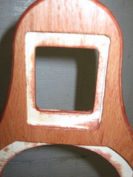

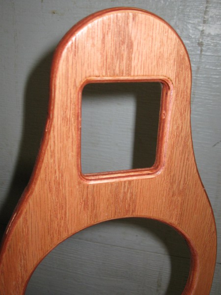

Yeah I was wondering about that when I saw your photo. Are you using the PRD or plain version? Do you have a chamfer on the back too? If you could post close-up photos of the front and back tweeter mount, that would be helpful. It's entirely possible that my diagnosis for the source of my response null is incorrect.I don't seem to have the null with my tweeters & all I've got at this stage is a 45 degree chamfer around them.

All I have are the photos I posted earlier in this thread:
http://www.diyaudio.com/forums/multi-way/186212-bohlender-graebener-neo3-2.html#post2527354
It's just a 1/4" roundover bit on a router, so it's not a calculated WG profile by any stretch 🙂 As DQ828 said, maybe a chamfer would have been better.

The various AxiDriver sims in the horn threads suggest a 5cm radius provides reasonable diffraction control with 10cm being better. Changing profiles on a 5mm scale isn't going to do much except maybe up around 20kHz where the roundover's starting to get accoustically large. It would, however, be interesting to put 1cm radius cylinders on the sides---about as small as will fit without machining down the Neo3 flange---and see if there's a noticeable difference. That approach is likely more significant than a baffle roundover as it's changing the boundary condition at the throat.It's just a 1/4" roundover bit on a router, so it's not a calculated WG profile by any stretch 🙂 As DQ828 said, maybe a chamfer would have been better.
A more natural size for the Neo3 is a 2cm radius which injects an extra 8cm or so of path length. That should move the dipole peak down from 3.5kHz nude down to 1.9kHz. Will make the blooming worse unless the increased smoothness and range of path length variation more than compensates for the closer spacing between dipole nulls. This is part of why Le Cleac'h profiles are interesting---they're natually 360+ degree whereas OS leaves 270 degrees from front to back unspecified. Le Cleac'h also allows a greater depth for a given width than OS and hence offers a bit more loading.

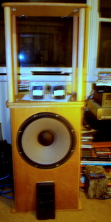

I made the first "waveguide" out of 1.5" pvc because I had read that JohnK used a 3/4" round over for his waveguide in his NaO Note. I guessed that John used a 3/4" inside + 3/4 outside round over = 1.5". When I installed the bigger tweeter/waveguide on the baffle it was way too wide, and I felt (as I understood it) defeated the point of a narrow baffle and avoiding dipole bloom. I guess it's all about compromises.
Unfortunately, I've recently broken my heel and can't hop around and get additional off axis measurements. I'd probably bounce the mic around too much to get accurate measurements anyway.
Here is an on axis measurement at 1 meter, mic located between tweeter and upper-mid of my attempt at a NaO Note clone. IMHO, JohnK's Note has to sound very nice.
