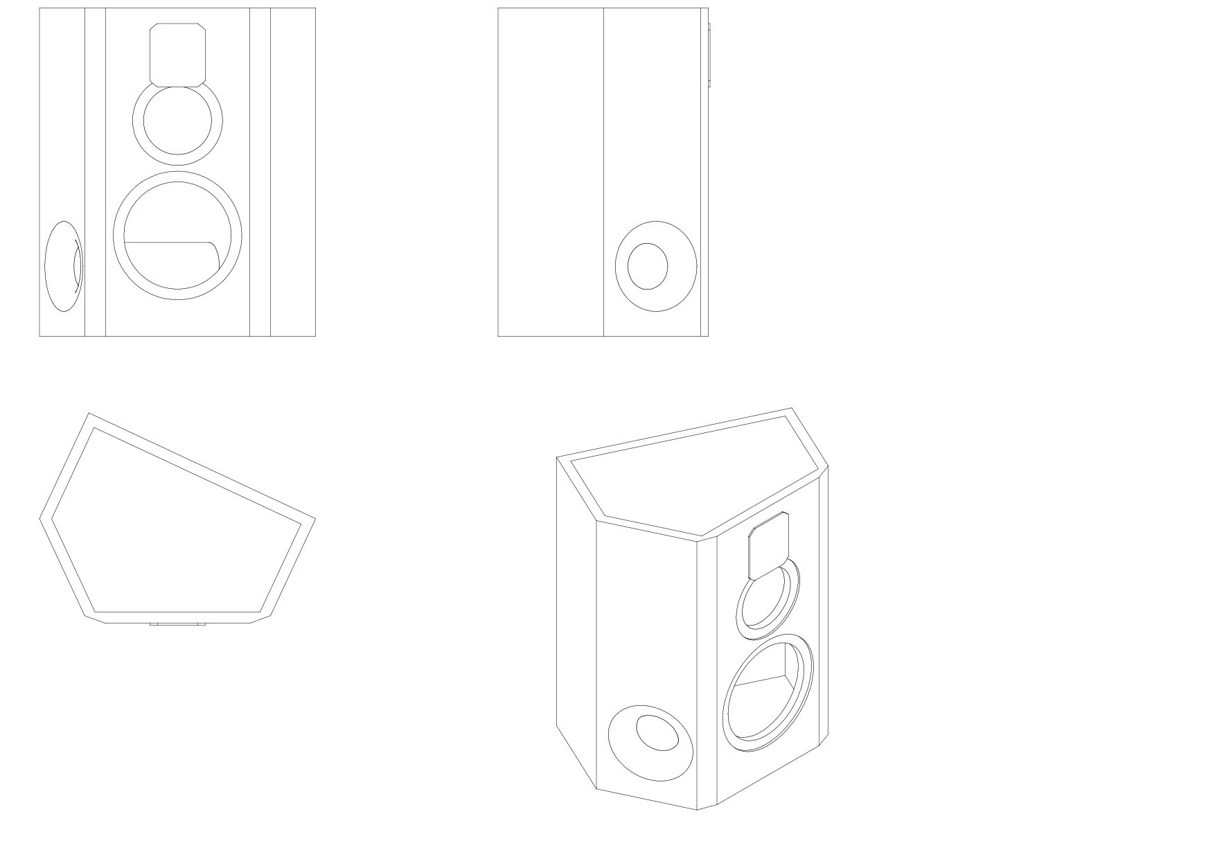

Below 4000hz I wouldn't use the Fountek but above 4000hz it has super low distortion and good resolution.
There is hardly a midrange driver that plays so high....
The combination is really successful, but before I lean too far out of the window, I have to listen to more music with it.
Have you already heard the SB23NRXS45?
It was a tough decision between the Dayton RS225P-8A and the SB23NRXS45. AJ Horn (simulation) told me that the SB needs at least 60 liters and plays low but already drops off at 40 Hz. The Dayton plays linearly down to 30 Hz and only needs just under 50 liters.
The low distortion of the SB Acoustics, especially K2, is impressive, especially as I could have it for € 80,--. But the HiVi does distort at this point just like the Dayton, so I thought, it fits.
