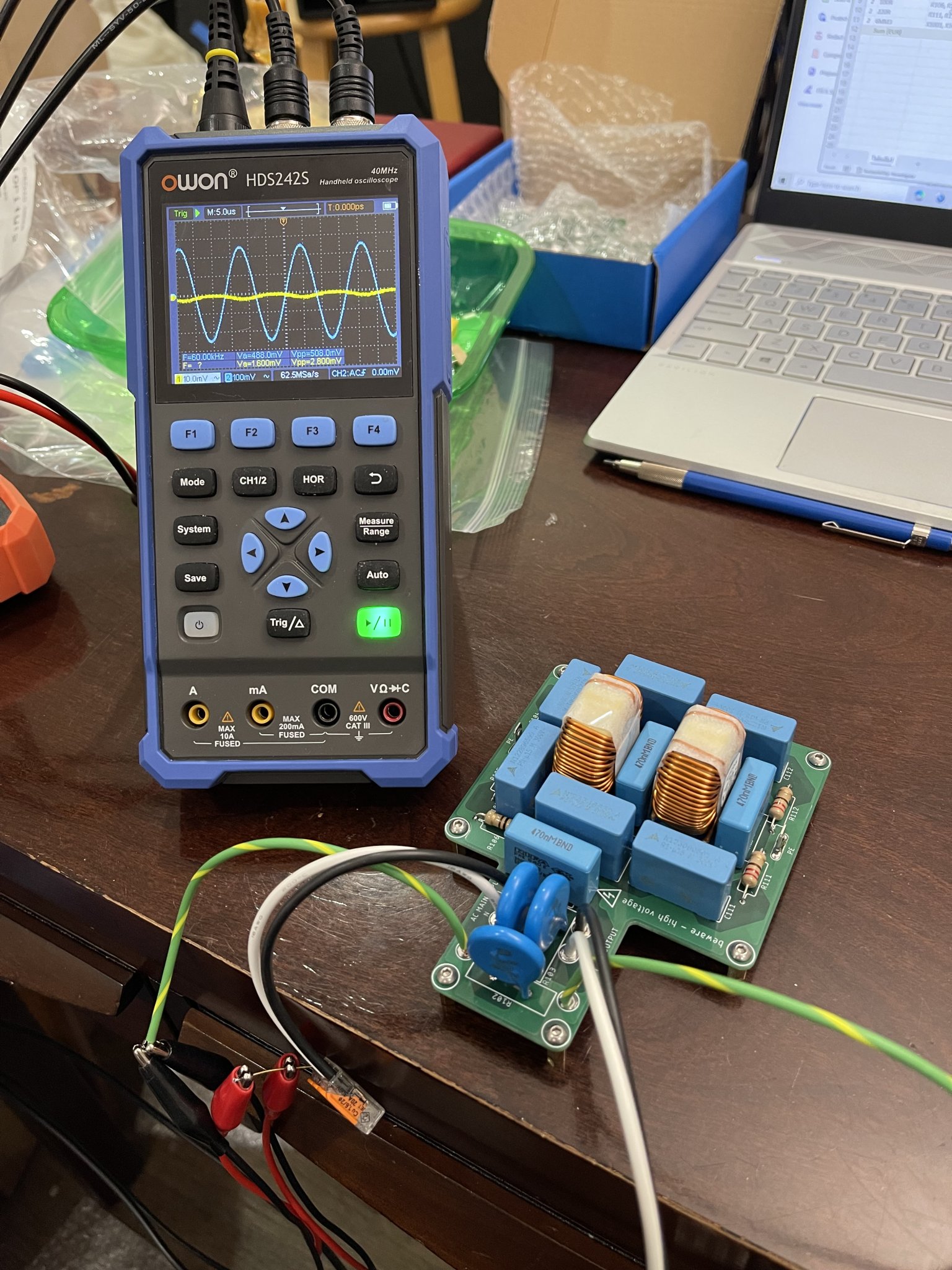

I use an Owon portable oscilloscope and it has a built in function generator for sine, triangle, square, stair step, and different digital pulse trains. I use it to generate test function waves and Oscope to measure the result with DUT inserted in path. Here is example of measuring transmission of 5th order Chebyshev filter.
Measurement shows 2.08mV out (yellow) and 508mV in (blue) at 60mHz for sine wave function.
