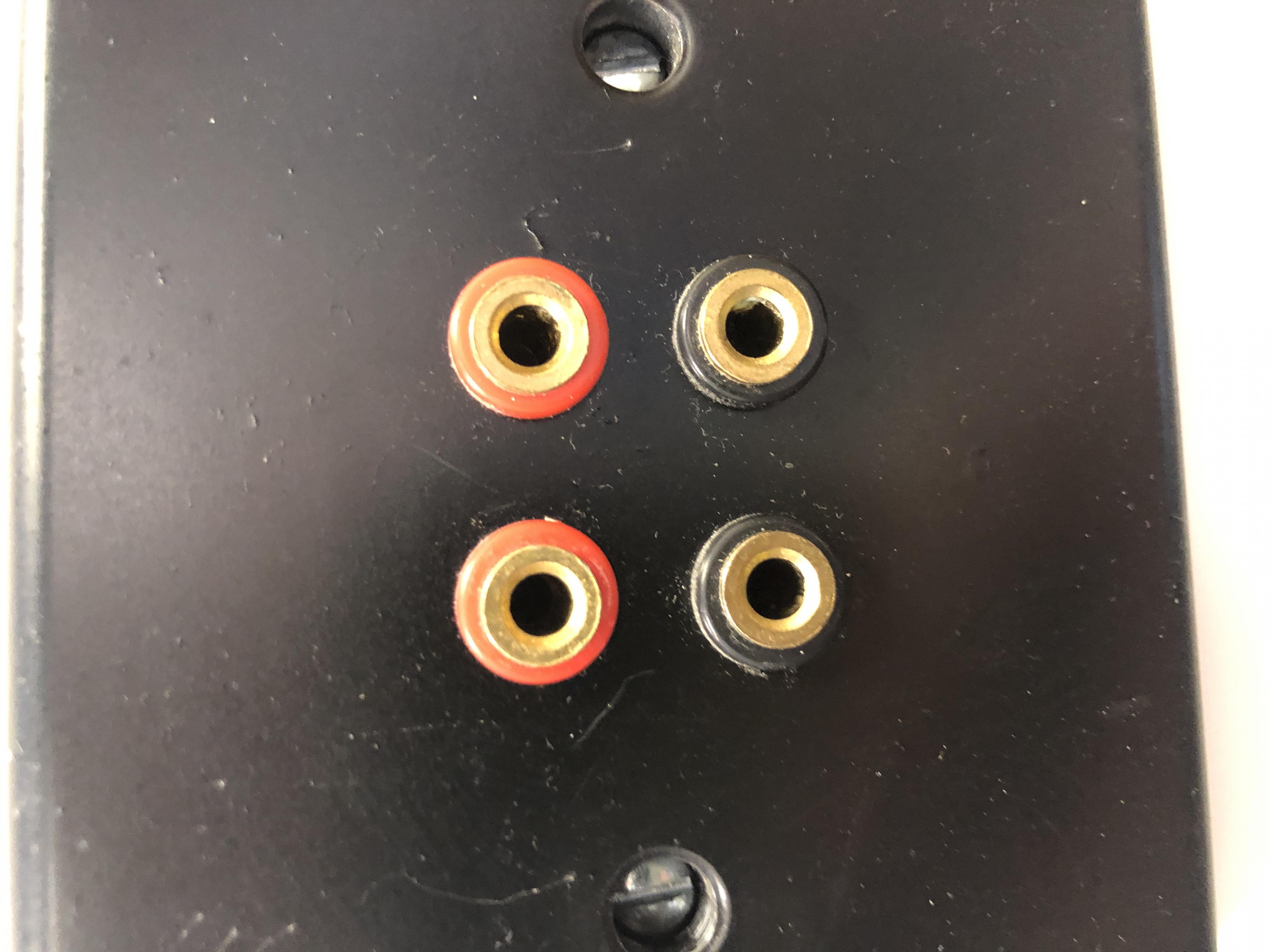

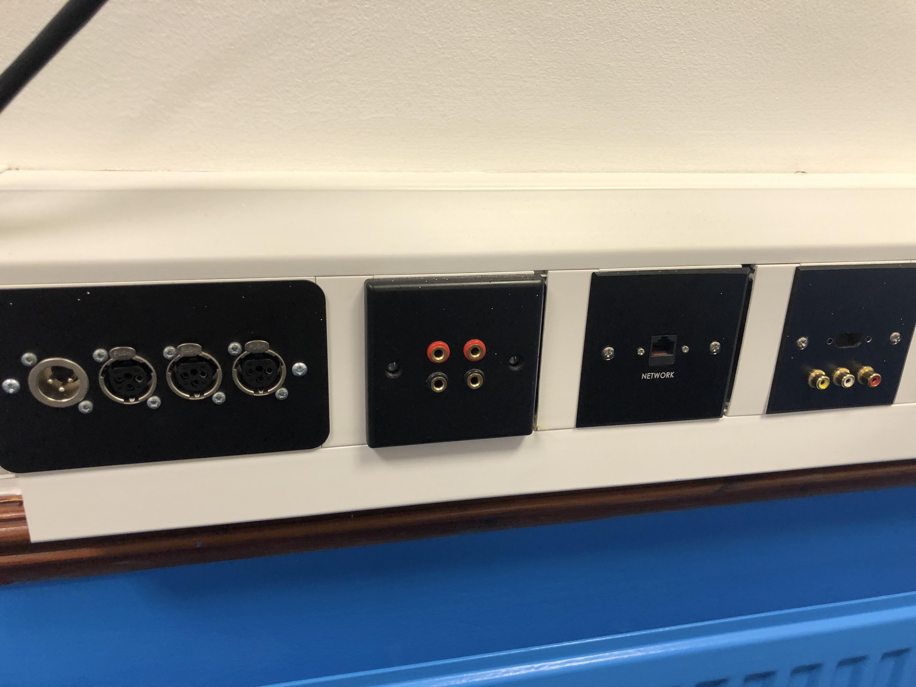

Hi sorry I'm a complete amateur with these things! I've recently taken over a room which has speakers in the roof. However, I do not currently have any cable to go into a socket in the wall to connect to something like my laptop. I'm assuming that I have to connect a cable into the red and black sockets and that the cable has to have a headphone jack at the other end to connect to my laptop... but I've no idea which cable I need to buy for this?
I'd really appreciate any help with this - thank you so much in advance 🙂

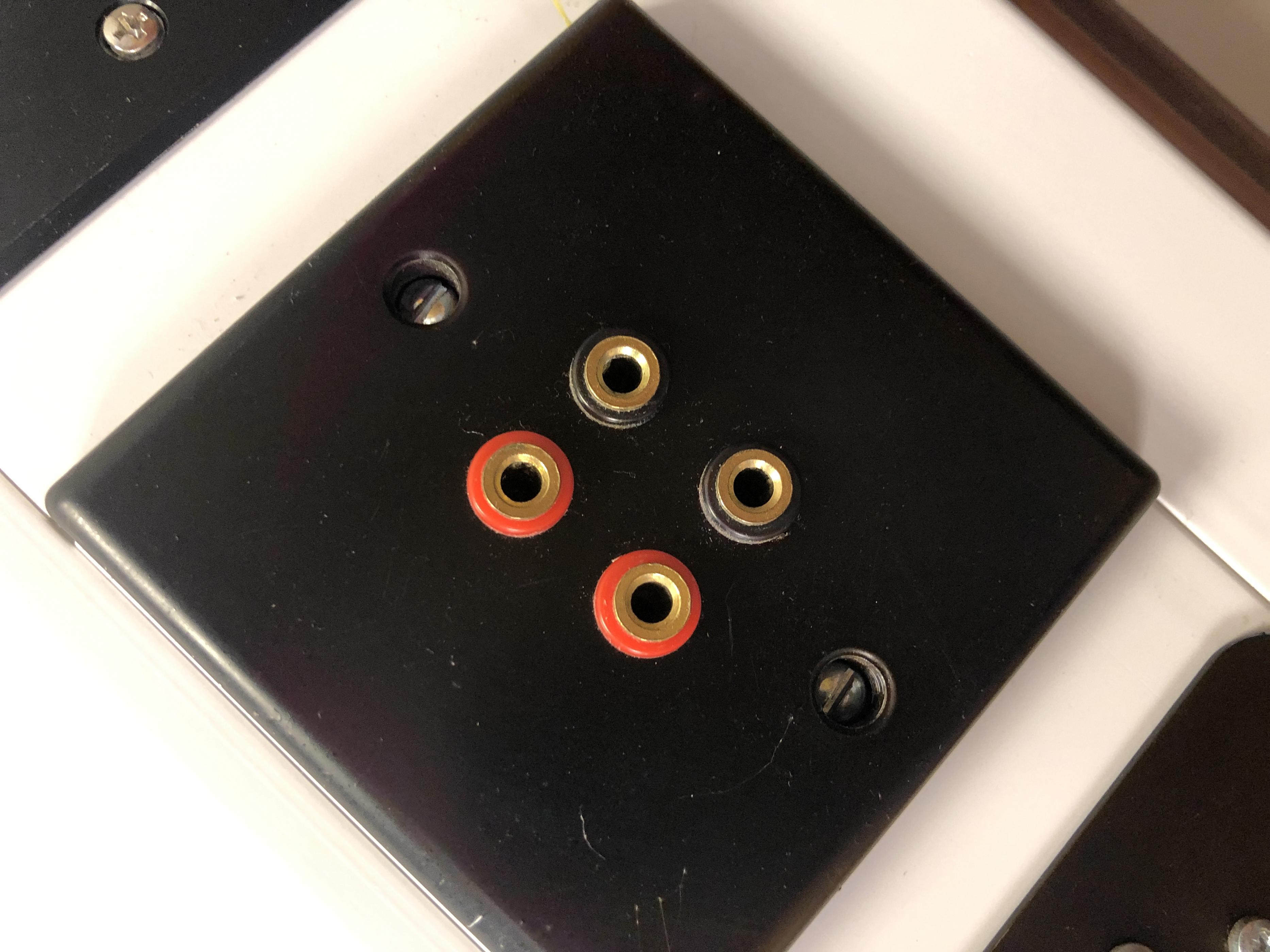

Thank you so much for your reply! I'm hoping that I've attached the images of what I'm trying to connect to as well.
I think that I have an amp in my garage that could hopefully connect - I'm assuming that whatever fits in those red and black sockets would have bare wires in the end that I can just snap into the amp?
Sorry - It's obvious that I'm in unchartered territory here!
I'm in southwest UK, by the way... I'll try to find a way of updating my profile 🙂

I'd like first to be sure that these are, in fact, inputs to the ceiling speakers.
Those are 4mm sockets and you need two cables fitted with 4mm plugs to plug into them. You'd need to inspect the rear of your amp to see how the cables connect there - sometimes it's bare wire connectors, but more commonly these days it's 4mm sockets.
Two pairs of these would do (different lengths are available), you can always cut the plugs off one end if necessary. MutecPower ULTRA Series Speaker Cable 14 Gauge with Dual Color Pro Series Banana Plugs 3m High Strand Count Copper (OFC) Construction -3 meter: Amazon.co.uk: Computers & Accessories
To connect laptop headphone socket to amp you would need a 3.5mm jack to 2-male RCA plug cable. AmazonBasics 3.5mm to 2-Male RCA Adapter Cable - 1.2m / 4 Feet: Amazon.co.uk: Hi-Fi & Speakers
However, I wouldn't go ordering anything until we are certain of the exact layout of your system!
Those red and black on the right do appear to be dual banana jacks which are commonly associated with speakers.
A dual banana plug from farnell or RS (uk distributors) could connect an amp with those outputs to those inputs. https://www.newark.com/mcm/24-2600/connector-type-a-banana-plugs/dp/26C9853
The link is the US warehouse, they may have something else in stock in the UK. I searched "dual banana plug cable". 6' is rather short, they probably have 12' and 20' ones.
To seriously determine if those are speaker connections on the wall, measure from red to black with the ohmmeter scale 200 or x1 of a DVM. https://www.newark.com/tenma/72-13435/dmm-handheld-manual-2000-count/dp/52AC3272
If the resistance if from 6 to 8 it is an 8 ohm speaker. If the resistance is 3 to 4 it is a 4 ohm speaker. If the resistance is 199.9 on 200 scale, then that is the input to an amplifier, or the wires are broken.
If you want to buy that meter in UK you'd search farnell UK site for 52AC3272. Or look for a DVM with an ohms 200 scale or an ohm x1 scale. they had cheaper ones that won't be very accurate at 6 ohms. You'll need a battery for that too, look to see what one it takes & order in same box. Farnell & RS charge freight, the secret to using them is put everything in the same box. Freight is all the same price up to about 2 pounds. Royal Mail may be cheaper than UPS, check that option at checkout to see.
Yes, that's exactly the kind of investigation that must take place before committing to further action.
If you can't follow these instructions yourself, then I'd look for the assistance of a technically knowledgeable friend or a professional installer.
