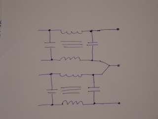

Franz G said:What L do you use?
Mostly 20VA 2 x 4.5V EI transformers.
They are a few mH and 2 x0.1 ohms
These are of course saturating with the DC but I understand that this reduces the bass response which does not really concern me.
In a split rail supply I would configure them as shown.
at present I am experimenting with discrete regulators after the choke stage but if they were in the cct I would only connect the grounds together at the PSU O/P
This is the only way I have found of equalling or perhaps bettering batteries
mike

mikelm said:schotkies followed by C L C L C L C
Forgive me for asking, but what is "C L ..." an abreviation for??
Cheers!
sss said:caps and inductors
Ah... I knew that it must have been a word NOT starting with "L"!
(L for Learner, in this instance?) 😀
