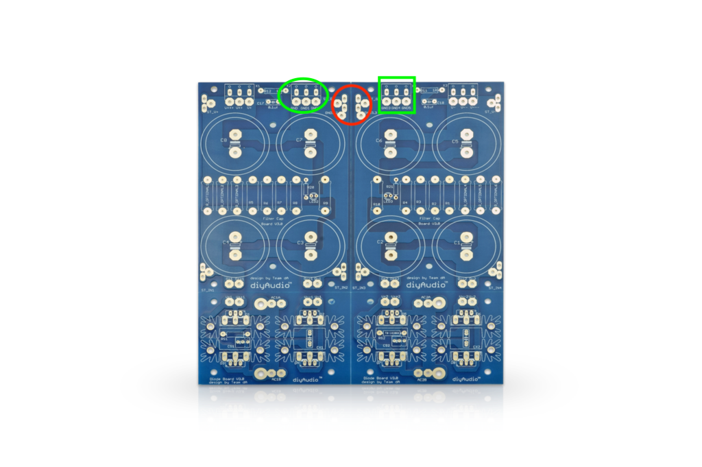

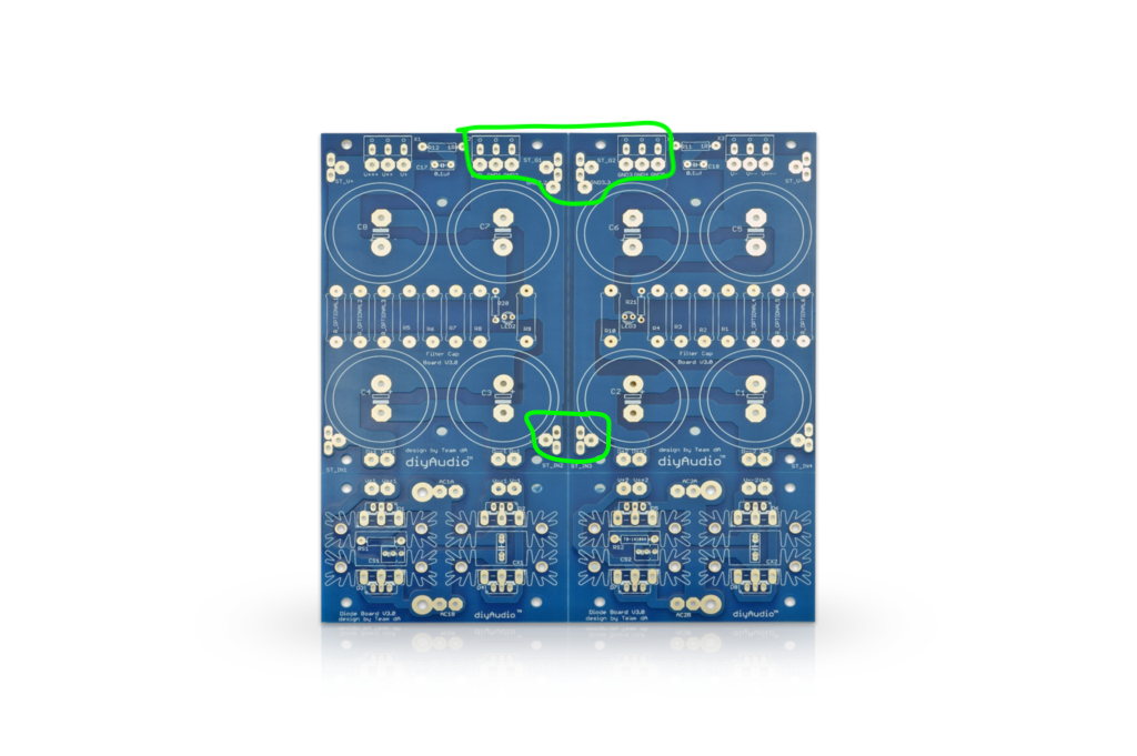

Best ground is at the power supply output where the power is the cleanest. Do not use the other location as a ground point.
How are you running them, each powered with a separate winding?
If so, keep them separate at the inputs. Only connect them together at the outputs,
which will be between plus and minus (GND 0/1/2 and GND 3/4/5) to make a bipolar supply.
So the green-circled connections, not the red-circled? What's the difference between those two?
Also; I've read that it is best practice to run the biggest ground wires feasible. Is there any reason not to run wires to all six ground connections on each board?
