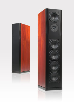

I have regular loud speakers from Krix Australia (Krix experience sound - Home). They are the Neuphonix. The bottom four drivers are for the base, above is the tweeter, then the mid is at the top. THey can also be bi-amped which I might consider a bit later.
