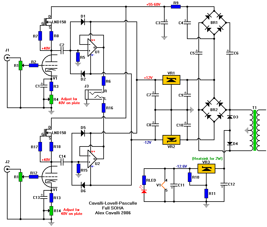

Is a headphone amp under consideration? How about the Cavelli SOHA from the old Headwise site? It's a hybrid, 12AU7 gain stage and OPA2136? output. Will drive anything but planars and electrostats. Powered by a 15VA, 12volt transformer, B+ about 60 volts. Uses mosfets for CCSs. Can be built on a proto board and a cheap eBay chassis from the Orient would make it domestically acceptable. Probably all in could be built for less than 100 bucks.
