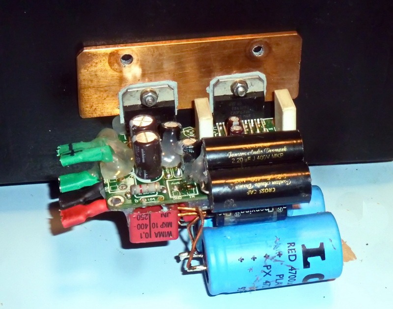

I'd like to build a new amp for my subwoofer (Mivoc AW 3000, 12", 4 Ohm > datasheet in 50l sealed). The linked speaker will be replaced by an other 12" ( maybe a Dayton RSS315HF-4 > datasheet ) with better specs, sooner or later. Atm the Mivoc is driven by 2x TDA7293 @ +/- 33V in parallel configuration. This combination isn't really bad at all, I like it, but you know, it has always to be more ( & more & more ... 😉 ).

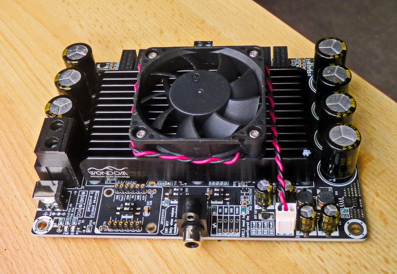

This looks interesting. I've never read about the TAS5630, as class D did not really wake my interest yet, but Ithink I'll give it a chance. I've got plenty of room under the subwoofer, as I took two old bookshelf-speaker cases and put the toroid in one and the amp in the other.
Thank you for this advice! (gonna read about the TAS5630 now. this looks really good 🙂 )
Just ordered this TAS5630 >
It requires besides the main power supply an additional 12V GVDD. Where should I take the 12V from? Could I take it from my (high quality FSP Aurum) PC PSU, or may I use a second small transformer with a LM317 + D-Noizator?

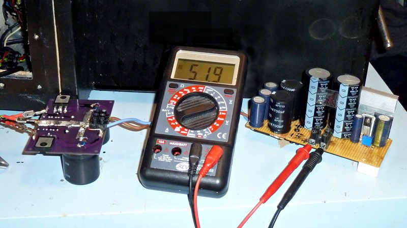

It's working. I didn't have a transformer which was able to deliver 50V DC with enough current. The one for my old SW-Amp has 23-0-23V which is +/- 33VDC, which makes 66VDC asymmetric. To reduce the voltage I put it first as +/- 33V through a cap-multiplier which I had lying around for my satellites. At the output it was +/- 28.5V. This I took as 57V and led it through another mono cap-multiplier with 63+ V caps which I built for the sub. Final result: 51.xV.
1st pic is the old dual TDA7293, 2nd the TAS5630
