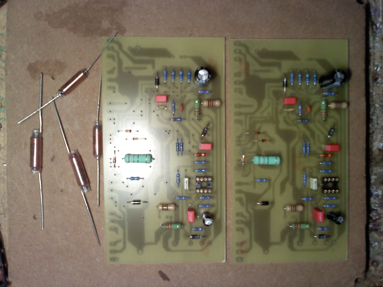

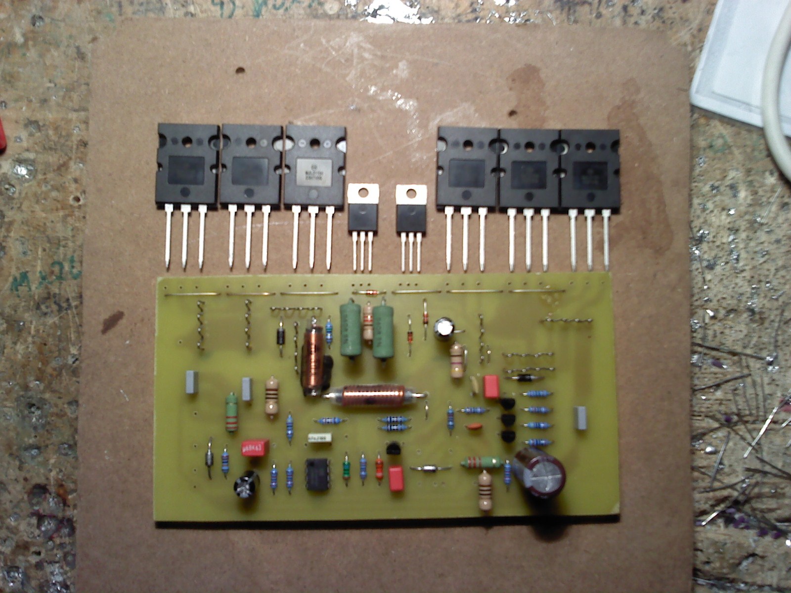

Bluegrass, I'm afraid that those Quad clone cards have gone somewhere. I couldn't find them so I made new pair for you. It is nice home brew. I used 70um boards for batter result. About materials for this amp. It is just nothing special. It is good to use 1% metal foil resistors and some good quality foil caps. But there are only 2 caps which could possibly affect to the sound. First is of course input 0,68uF cap and the other is 47nF cap located in the feedback of the op amp. Only somehow special components are 560E 3-4w resistors but you can order from farnell. About op amp. It works with practically every single op amp in dip8 pack. I tried tl071, ne5534, op27...and many others. I prefer opa604, because of it's good price performance ratio. I work with sound every single day and I think that difference between op604 and some expensive op amps, is so minor that is hard to measure and almost impossible to hear because of modest requirements of quad's input stage. My favorite is opa604. And now transistors. For small signal transistors i suggest MPSA 42/92 types if you choose supply voltage higher than +-50V. Drivers are MJE15031 or something similar. In fact there is everything ok if you choose some slower drivers like BD244c. Output transistors which I use are just simple and somehow conservative MJL21194. You can get them cheap but be sure that they are original ON SEMI. NO china fakers. If there is somebody who can help you to match them it will be nice. You can also built your own transistor tester. Measure them by use of universal V,A,Hfe....meter just doesn't make any sense because conditions of measurement are unrealistic for such big transistors......But if is too hard for you to match outputs i can calm you down. These devices are excellent and are made in tight tolerance. There is cc 20% of mismatch.
So nothing special. I'll check downstairs if there is some of small material for these amps....resistors diodes....and will send it to you as well. It is worth almost nothing so don't bother. I'll be glad to spare you some work.
Good night
Some photos. Pair is yours Bluegrass. Hopefully I will finish( with stuff which lies around ) and send them in Sweden.

Hi Tajzmaj,
Thanks so much for the effort you are putting in, I really appreciate it. I used the opa604 with my Quad 405-2, it came with the upgrade kit i bought, and seems to work really well. I appreciate your working with sound, in that way we are similar. I practice and record everyday, and play gigs of course. I think doing recording gives you a 'common sense' approach to sound and gear. Things need to sound good, but also be good value for money, and above all, reliable. Expensive cables don't make much sense once you know what cables are used for mics etc. Just good quality standard cables sound great to me! So with these boards, I will need to get some advice from you on how to build the amp and what other bits i should get. This will be my first amp semi-build, and lets face it, you are doing lots of the hard work for me. All the best for now, and thanks!

Bluegrass, i will draw and write everything to you that it should be easy to build this amp.....Have you got any option to buy proper enclosure in Sweden....Otherwise there is quite good company in Italy.
modushop.biz
Don't expect to much from this enclosures but they deliver fast and for my opinion have fair price performance ratio. You will nee something like 3H and 300mm deep, and with such heat sinks it will run almost cool. Again reliable......
Caps. I put something around 2x20000uF for each channel. It is good idea to buy more smaller caps and wire them parallel to get higher current and less inductance. They should be rated 80V at minimum. 100 volts is maybe batter value if you like to leave your amplification ON for long periods......it will increase life time of caps.

Sorry not by me. I have collection of classical ,,legendary,, amps, properly renewed and the others are my own home brew products. If you are experienced by making pcbs I can post you p-cad file for kind of quad 405 clone. I have nice version for 2x100w output. Small card.....but without any documents and instructions how to build it. I have it just bare. It works. Proven. But you need some skills.You have to watch circuit and make the rest. I also see some really nice projects here on diy Audio.

Just a few more important things about building an good quality amplifier. Maybe it would be batter to start new thread for all the beginners but.......
When you choose right circuit which satisfies your needs such as quality, power, reliability, weight(touring applications),size,price......and many others, I sometimes build something just for fun and because i am curious how it works.........
Very important is than to build amplifier good in mechanical aspect. It should be compact, you should track the logic of the circuit. For an example. It is bad idea to put inputs and power transformer close together unless you want some hum to be present all the tome as a background in your music......
Some elements dissipate heat and it is very bad idea to mount them in contact with electolytic capacitors......
And now the output transistors. They should be mounted on heat sinks large enough or too big for the power which they should cool down. Operational temperature should not exceed some 60 degrees of celsius, or lifetime will be reduced. It is important to mount transistors on absolutely flat surfaces. Be care full on edge around the hole which you drill. Firstly there is no flat surface and secondly it will punch through mica insulator and cause at least short circuit to the power lines if it wont even destroy something. Try to avoid rubber insulators because they are mechanically sensitive and ere hard to remove when are overheated if amp needs some repair. Don't scrimp with thermal conductive paste. Excess of it is good to clean because otherwise the dust will stick on it.......
It is also important to have good ventilation of enclosure, or all of elements especially caps will suffer from reduced lifetime.
Be prepared that when you once complete bare electronic there are costs just began. Mechanic is more than 2/3 of the final cost.
