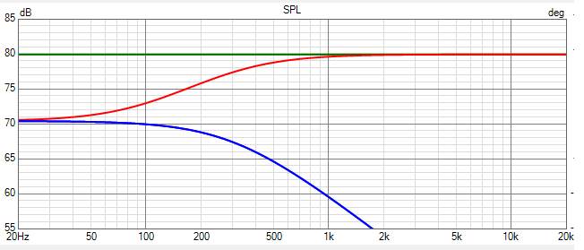

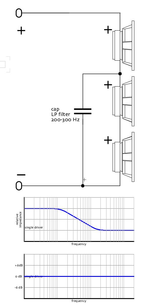

For baffle step compensation you need 6dB.Yes, big cap, it says that in the picture.
These 2 solutions have completely different aims. Use an inductor and all of a sudden you have 6dB too much room response. Not the case for the series connection.
But usually neither is the goal, 2-3 dB of LF gain more useful.

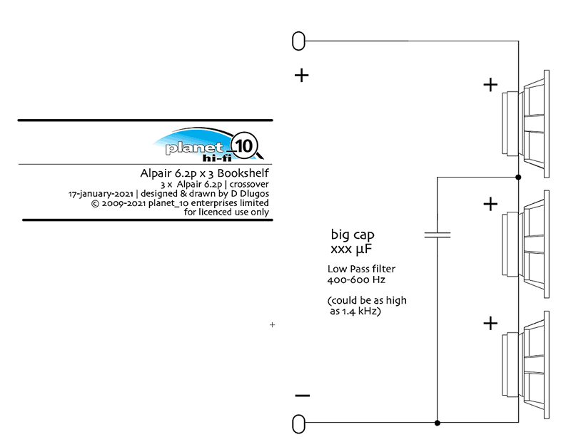

When you want to use 3 speakers, just put two in series.
Although it won't give you much benefits because the one that is playing fullrange will reach its maximum before the other two.
For a 1.5 way system I would keep it simple with an inductor.
That way the speakers also won't interact with each other.
