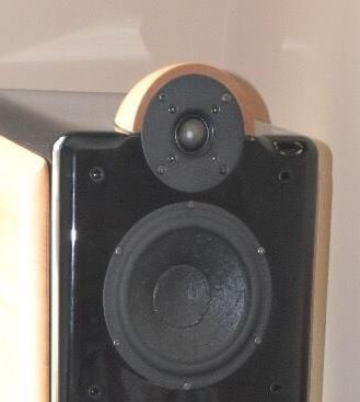

P.S. - By the way, I'm aware that the tweeter compartment on my Focal Profile speaker is quite reduced to accomodate a bigger one, so I have the idea of making some extension on the top of the cabinet to accomodate the new tweeter. Maybe something like this 👇

Not sure you need to do this ugly thing you call extension in front of your baffle... You have small form factor tweeter like this:
https://www.seas.no/index.php?optio...cd&catid=45:seas-prestige-tweeters&Itemid=462
To be honest, I don't think it's that ugly myself. 🙂
