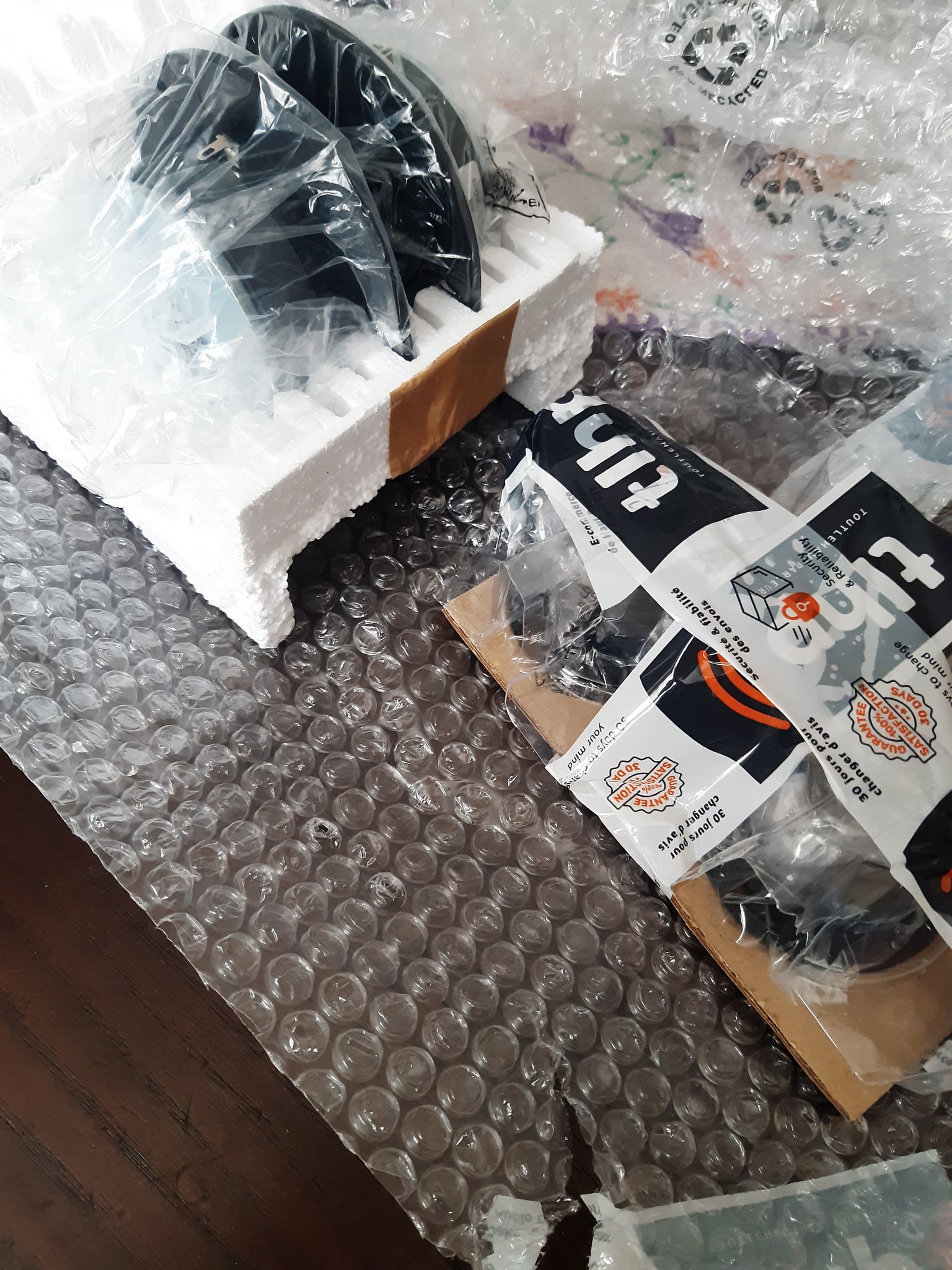

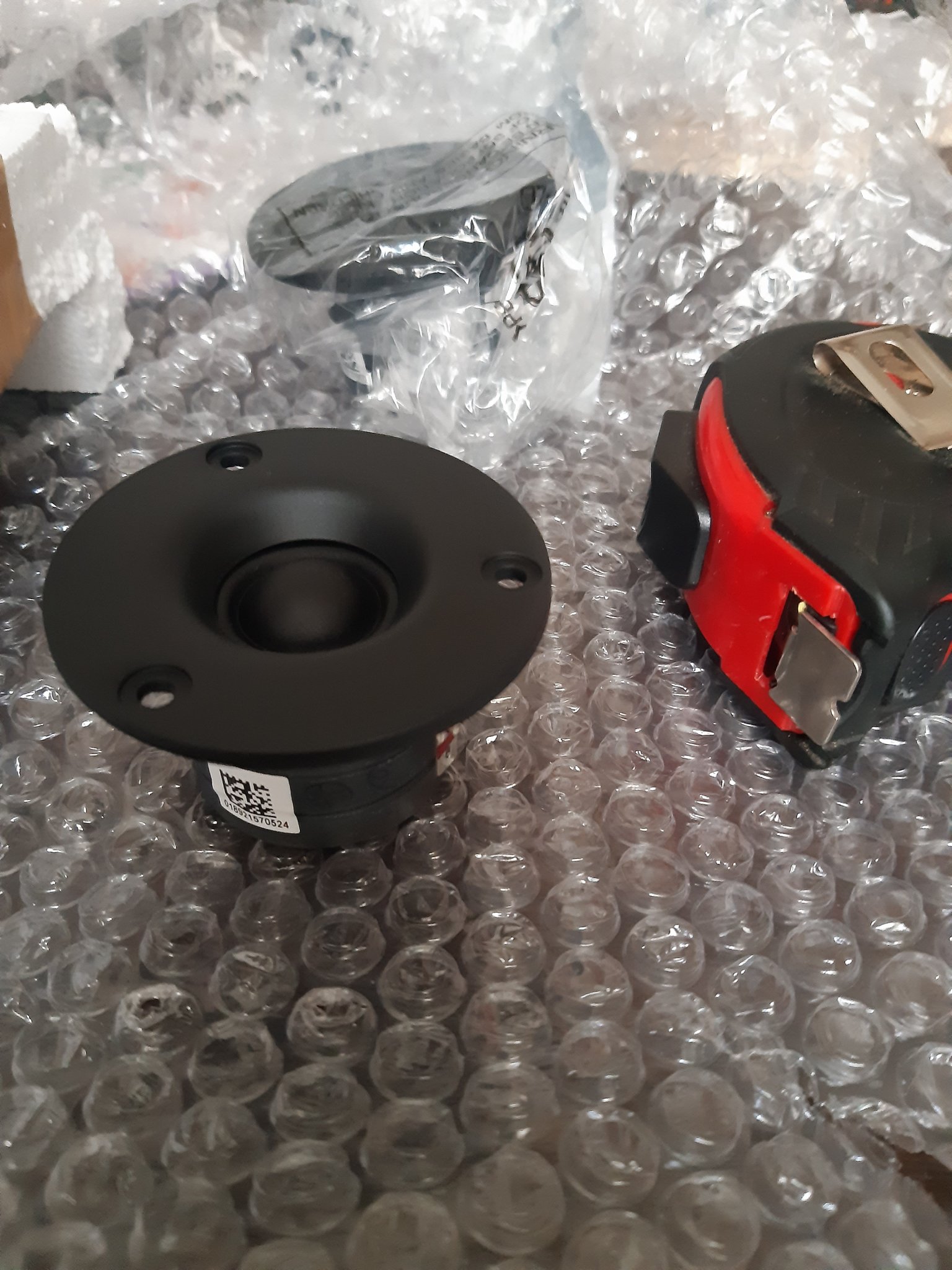

Hi fellows. DX20 finally chosen. Will go with Dayton if I do not like it. The 66 mm diameter for a xo at 3k helped for the decision as the low Fs for a try with a 12 dB high pass. The apex of the dome is 3 mm beneath the front plate...helps a little too.
Thanks again.
