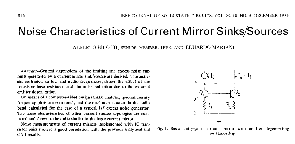

Fortunately you CAN find a PNP pair with better voltage noise than the SSM2212. Whether this is actually beneficial, or not beneficial at all, you can do it.
Bilotti's paper (snip attached) discusses the noise contribution of current mirrors. And of course lots of SPICE circuit simulators include a .NOISE analysis feature, so you can compare the simulated noise of your overall circuit with a transistor current mirror, versus your overall circuit with an ideal noiseless current mirror. IF YOU BELIEVE either Bilotti or SPICE, they may tell you whether it is actually beneficial to seek out and use ultra low noise PNPs to build your current mirror.

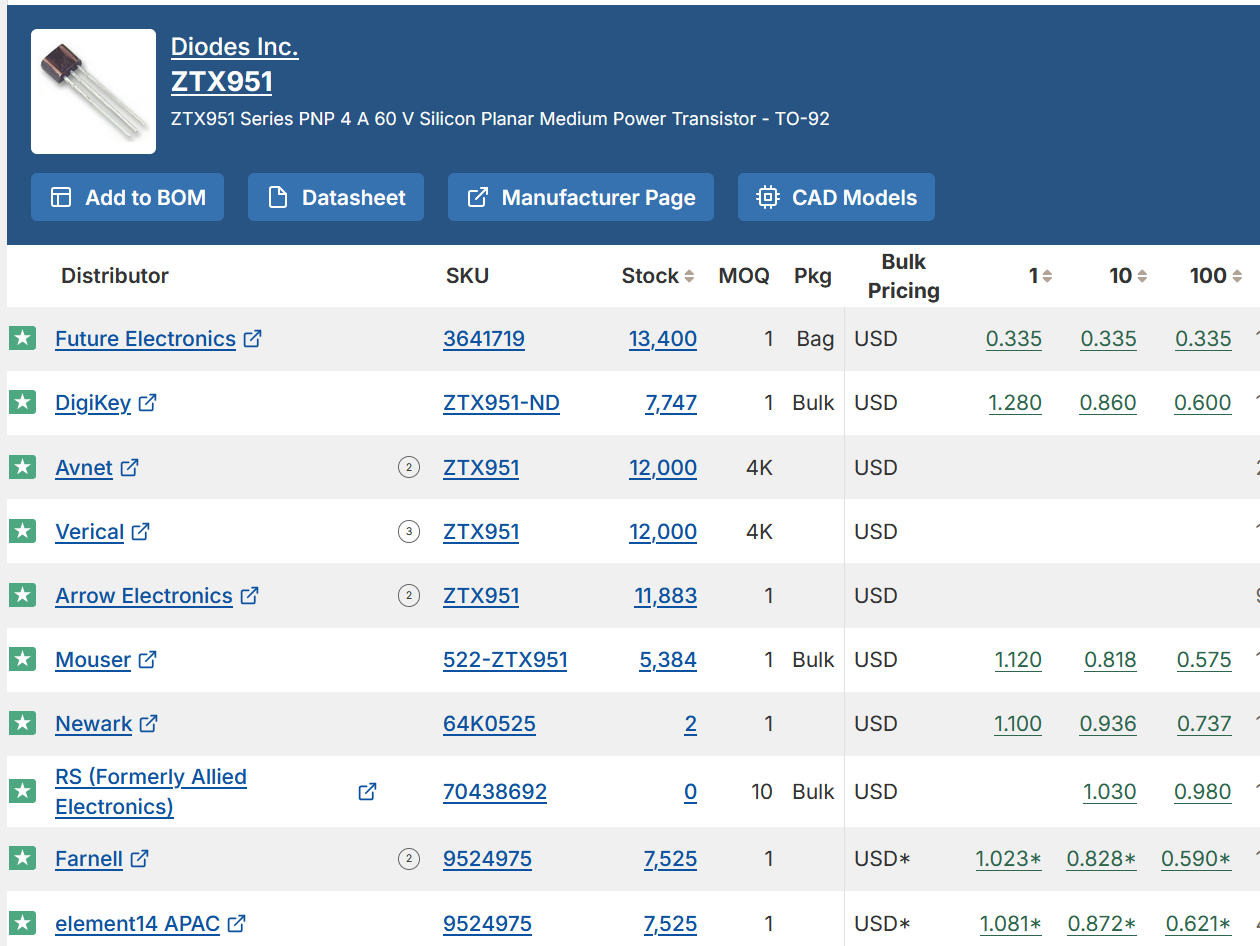

The spectacularly great, lowest voltage noise ever seen in a PNP, transistors are discussed in the 3rd edition of The Art Of Electronics by Horowitz and Hill. It's an excellent book that everyone who calls themselves a circuit designer should own. Part number is ZTX951, prices below.
It wouldn't be crazy at all, to make a decision like "Even though there is no theoretical benefit from using supremely low voltage noise PNPs in my current mirror . . . . . . I gotta use PNPs of some kind or another, and what's so bad about using PNPs that happen to be (needlessly) low voltage noise? Nobody gets hurt, I feel better that I picked the best possible parts, and oh by the way, they're not very expensive according to octopart.com so I'm not squandering giant piles of cash"

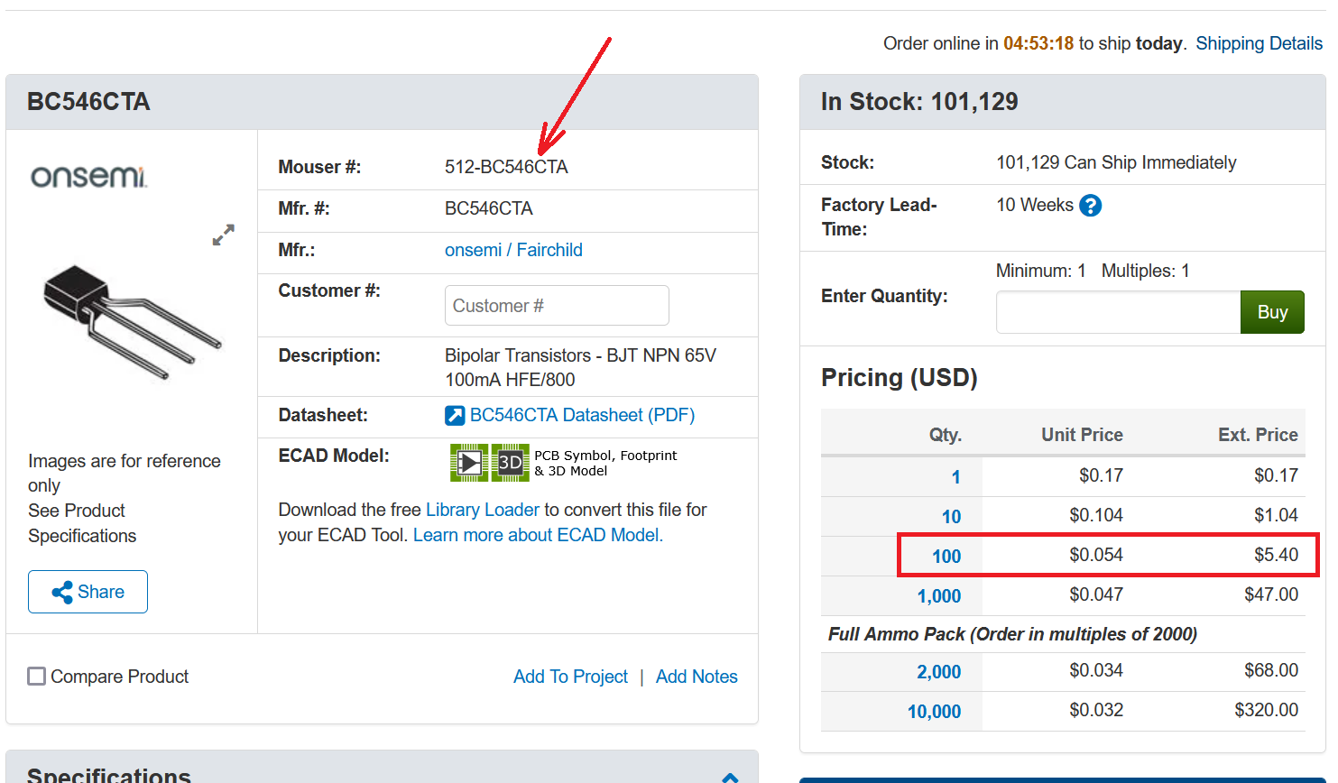

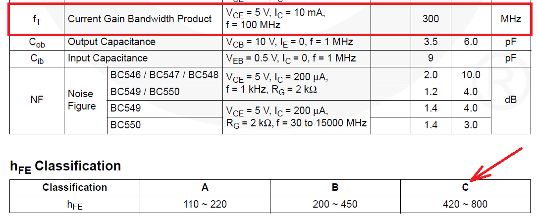

The ultramatched pairs used in my example design presented at Burning Amp, cost $5.46 for a bag of 100 parts. In an hour of testing you can get 5 or 6 pairs of matched devices, whose Vbe's differ by less than 0.5 millivolts.
