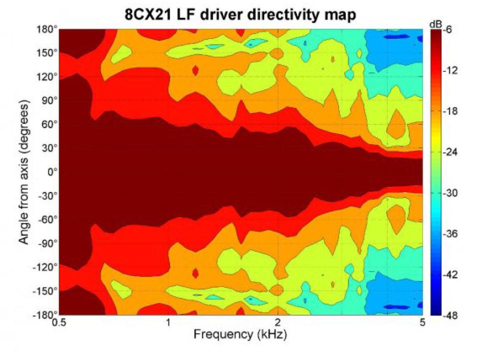

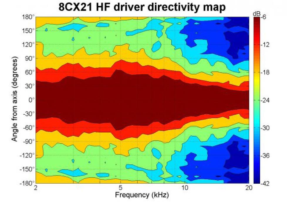

It's moreso about the directivity match. Basically the 8" and 12" cones respectively will designate the tweeter's off axis response, whereas for the woofers, the direcitivity will be increasingly narrow as frequency rises. So the crossover point is best determined by the point where the tweeter's off axis response matches the woofer's off axis response.
OK, so here are the directivity maps for the LF and HF units of a B&C 8CX21. They recommend a crossover frequency of 2.2KHz, which seems to match up pretty good. Both the LF and HF units are radiating at about 30 something degrees at that point, am I reading these maps correctly? I can see also that the LF unit starts to beam just about that frequency as well, so it looks like it would be a good place to crossover.

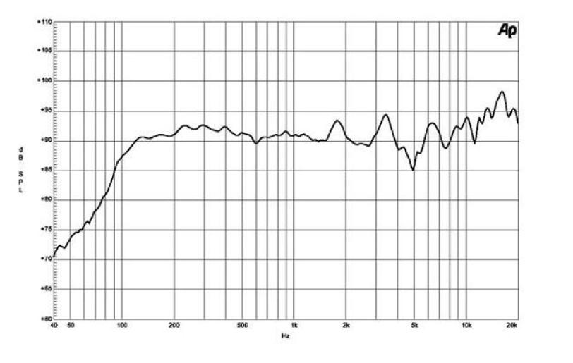

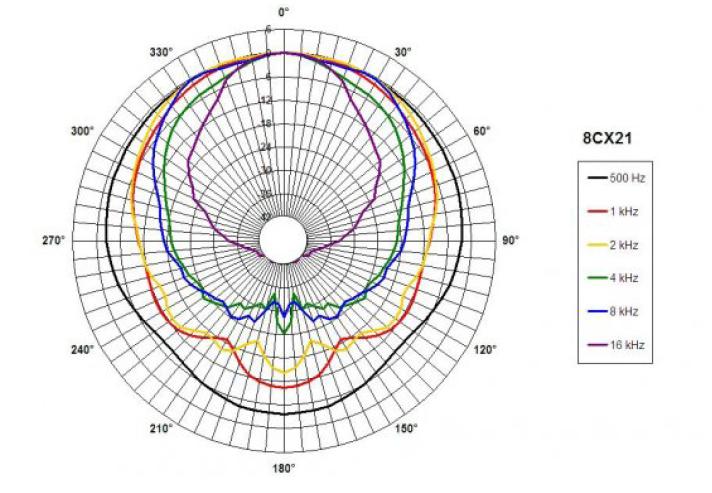

So, here is the polar plot and frequency response as provided by B&C. What could I tell from these two charts about how this driver would sound in real life? I assume that they are using their own passive crossover, the XO-1. I've seen pictures of the crossover and it didn't look like much to me.

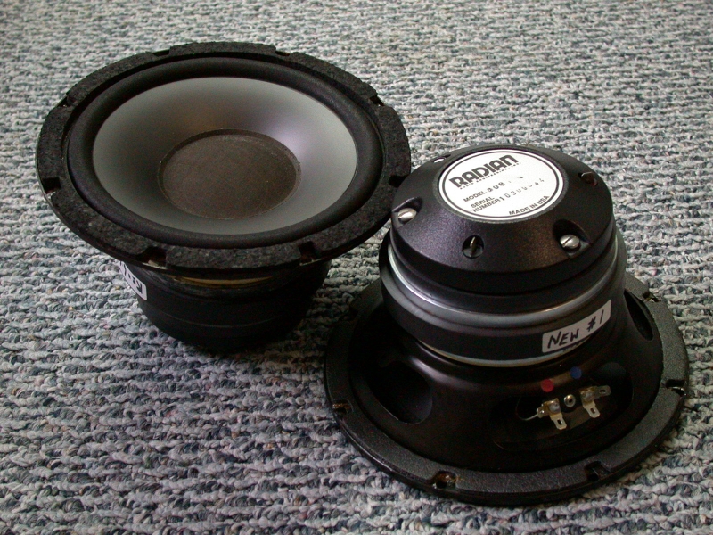

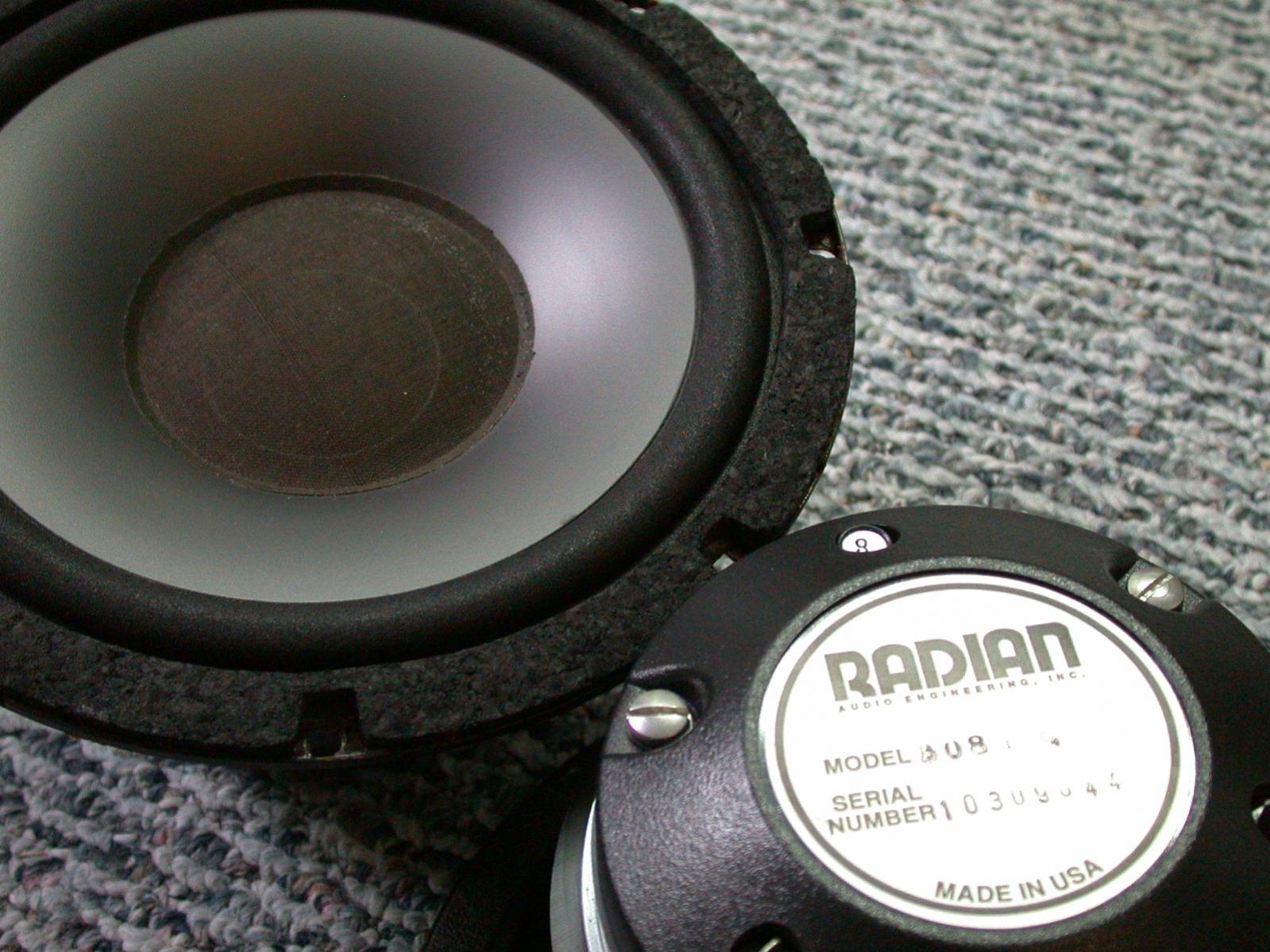

You haven't heard these then - Radian 508/2 🙂. Pity Radian doesn't make them anymore. They are from their "Studio" range. Polypropylene cone with foam surround.
Radian only manufactures the 508/2B version nowadays. The 2B are for SR not hifi.

Aluminum with Mylar suspension.
