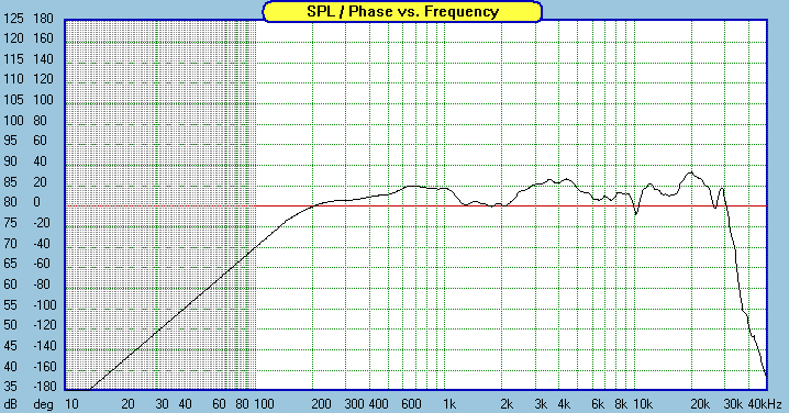

My advice, if you want a small single driver satellite, I don't recommend anything smaller than a 3". 2" drivers don't go low enough to cross to a subwoofer, even if run full range. And if you run them full range, they handle about half a watt.

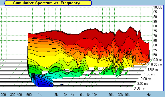

I've done tests of the W2-880. I don't recommend using this driver below 600hz, or above 8khz. Distortion outside of that range is horrendous. 2nd harmonic distortion skyrockets below 600hz, and there is a nasty energy storage issue at 10khz. I'll attach a few images. Frequency response isn't that great, but controlable enough. I see a certain use for these drivers, and that's as a midrange in center channel speakers.

Here's the waterfall. Not too bad, but something funky going on at 10khz. I think I can hear it as an occasional sharp edge in harmonics of some instruments.
