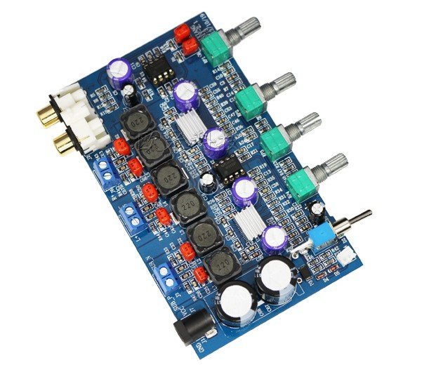

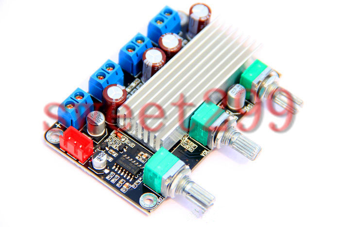

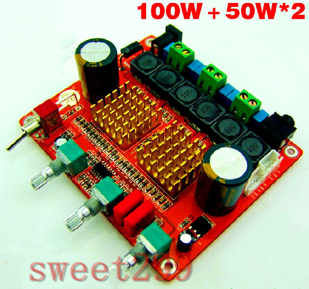

Looking for a TPA3116D2 to play with, I have access to a few, some with OP amps, some with caps, ... it can be hard to navigate through the lot and quite easy to get lost!
Don't have much experience with class D amps, so turning to the "pros" 😀

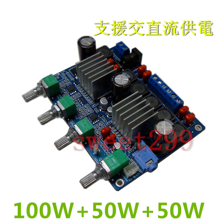

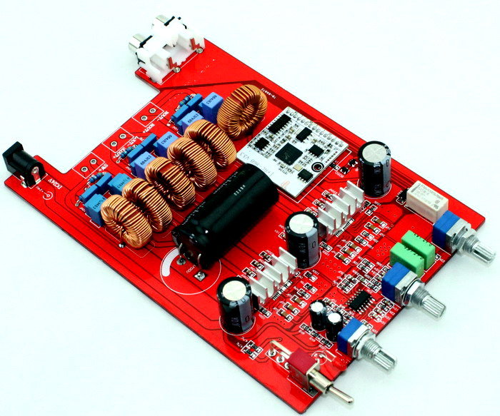

Here's a short list of some of the 2.1 boards available, in 50W+50W, +100W.

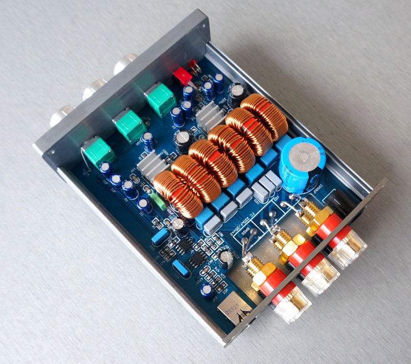

I believe TI specifies ferrite bead filter is within FCC (how is radiolaw where you live?) with twisted speakerwires till 1.5 or 2 meters. In Japan it is probably not legal, very strict laws there🙂 This board has FB on output, so no peaking outputfilter with any speakerload, also less distortion and better efficiency?? probably, if chip isn't tempted to become a radiotransmitter🙂
Couldn't you simply put it in a metal case?
But cables have less resistance than thin copper layer on the PCB I guess (?)This one? Short speaker wires? Meaning not a long run between the amp and the speakers? I may need about 2 meters of cable between amp and speaker.
Yes maybe when you keep speakers and all wires within case too. In Japan would say: only allowed for laboratory usage 🙂
Are there any boards allowing an adjustable crossover?
Most of those boards just let you adjust sub output volume and mains L/R output volume, then overall volume. Meaning the full range of frequencies are sent to both mains and sub lines.

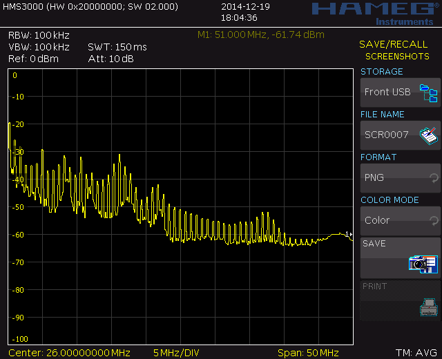

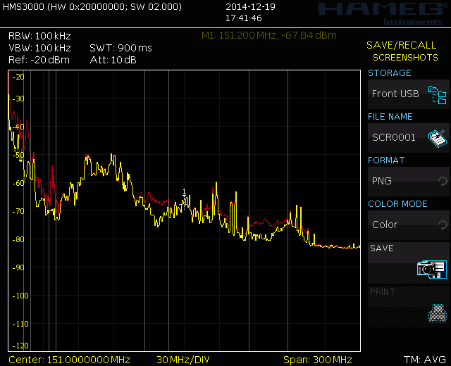

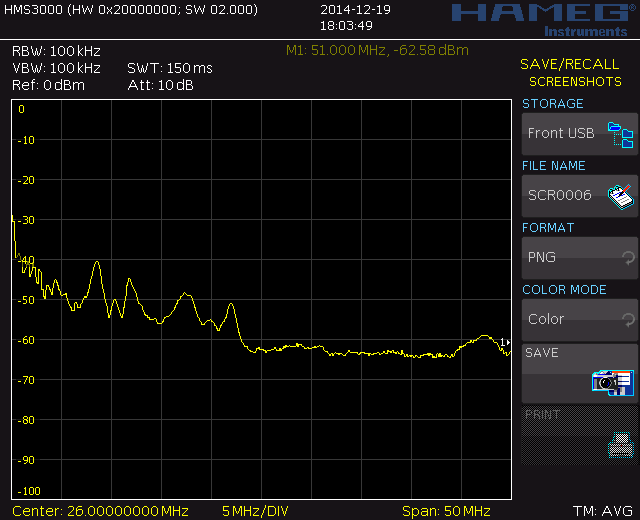

Well, measuring the TPA3132D2 (Simililar to the 3116/3118) with only fb-filters transmits some "noise" but not that much to worry about.
(Measured at PVCC=20V with 8Ohm speaker at 0.7m speaker wire, HMS3010, HZ551 probe at 1m distance)
Amp on, idle:
Those "peaks" are just harmonics of the switching frequency, better seen here:
Amp off:
Amp on (idle):
