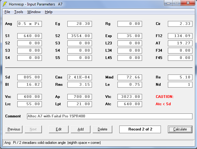

15PR400 will work well. I'm assuming that is the model you're looking at.

back from vacation, I am again tinkering around in Hornresp trying to simulate the Altec A7 cabinet.
I have simulated various drivers, but getting only marginal differences. a few dbs here and there in the freq response, moderate variation in group delay and impedance plots.
my main gripes:
1) i want to make sure first of all that the FLH part is modeled accurately. Once I can trust that part, I can focus on the low end tuning.
2) I copied the values of Vtc and Atc from Phils original simulations. Are these correct?
3) the parameters for the GPA 416 are incomplete, missing Cms and Rms..... I'm not sure how trustable the simulation can be under this circumstance.
4) In halfspace the simulations look like a mountain range, even with the fabled GPA 416. The cabs will be used indoors, probably placed close to or in corners. In Quarterspace the responses even out considerably to a more presentable shape.

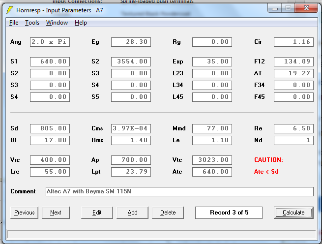

I was looking for woofers that have reasonably similar Mms, Qts, Qes and Qms compared with the GPA 416. I was concerned if a low Fs would be necessary, but I didn't see any big differences in the simulations. I was also assuming that a low Le would be beneficial for the midrange sound. And what about Vas, would a close match to the cabinet volume bring any benefits? Any comments on my strategy/assumptions?
apparently I DIDN'T copy Vtc, it was calculated by hornresp from my transducer inputs. Phil had manually entered a low value for it. Also, I was able to duplicate the sharp lower cutoff shape of his simulation by setting Rg=5.1 as he did.

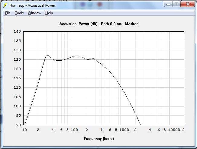

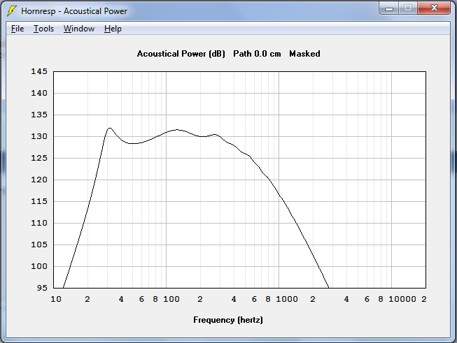

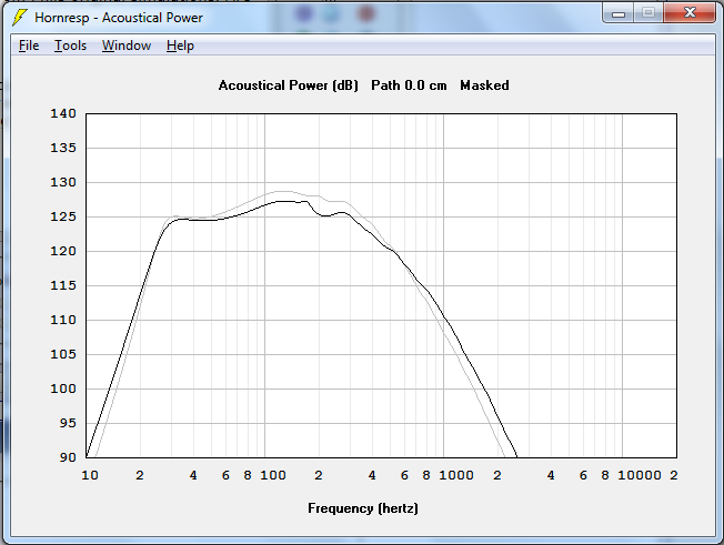

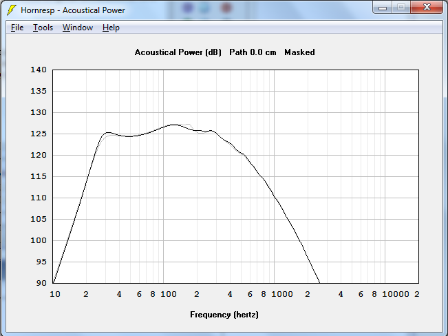

I played with the enclosure size, and cut it down to 250 to get rid of the valley between the low cutoff and the midbass hump. I attached a comparison of the Beyma and Fane. The Fane produces a more pronounced midbass hump, while the Beyma is flatter. I then compared different internal cabinet volumes with the Beyma, 250L to 300L, and 300L to 400L. 300L looks like a good compromise, and is probably realistic taking into account that a big and deep port will be needed that will decrease internal volume.

Regardless, at a glance, I don't see anything technically correct, though the horn response sim isn't all that far off, so got a lot to post re sims, Altec Vs GPA and other replacement driver choices with not much time all at once, hence will be posted piecemeal as time permits.
The highlights/essentials:
Vtc, Atc is irrelevant and can be left blank since it's a 1:1 CR and the driver is pistonic over the horn's gain BW.
Horn is a 110 Hz expo with a 128"^2 x 5/8" [baffle depth] conical throat.
Rear chamber is technically a two segment BLH with conical, then parabolic inverse taped TQWT and of course vented [mass loaded]. Note that the 825's open back horn cavities function as a crude band stop filter.
Recommend avoiding GPA if you want a true/best overall Altec A7 performance and find a driver with specs similar to the original 803 it was designed for [tuned to actual Fs] and only use AlNiCo spec 416 if wanting a [much] lower tuning than stock and/or use a high enough XO point to tone down the horn's output, leaving it basically a WG.
Frequency response wise, you want it to look like a lead guitar's where its breakup modes BW fills in/extends the horn's response to ~3.5 kHz/5-6 kHz F12. GPA's OTOH are nominally flat like the last of the series were, leaving the horn a ~ 'one note' honk that they rolled off using a 1.2 kHz XO to 'kill two birds with one stone' with the other of course being to get a much higher HF horn power handling.
