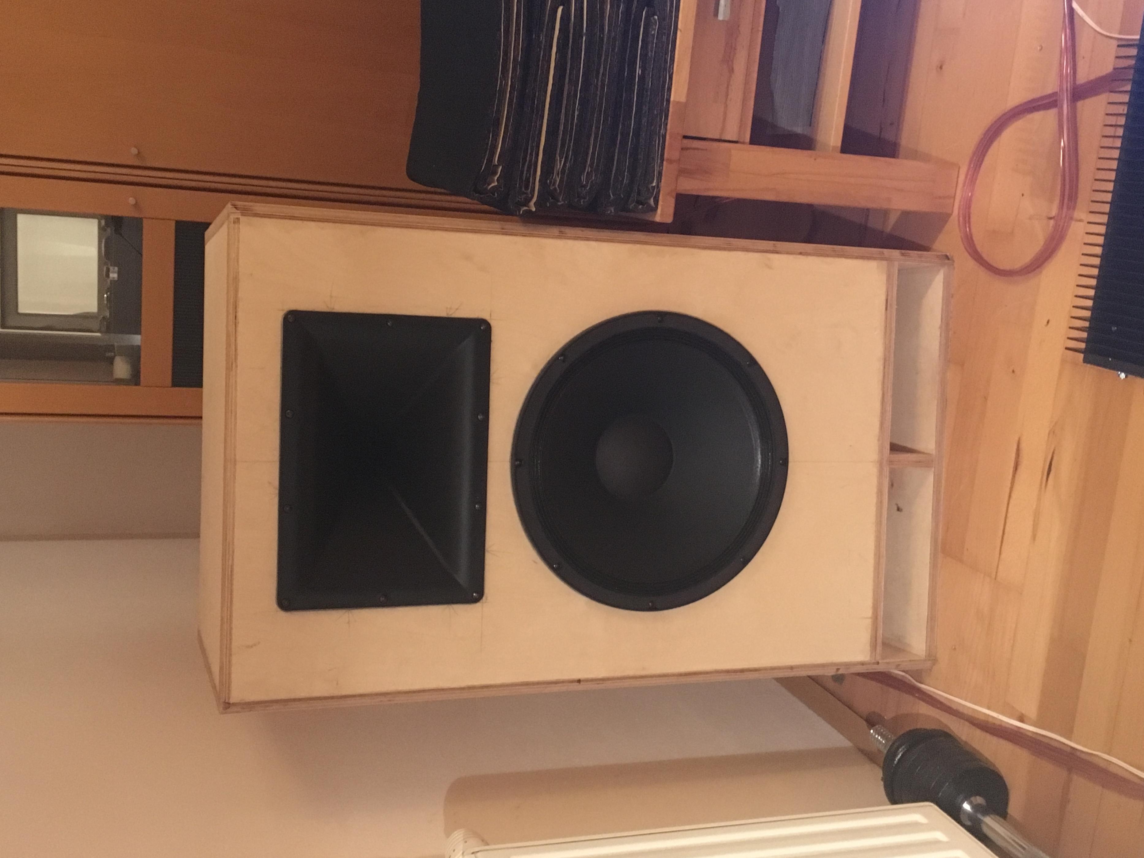

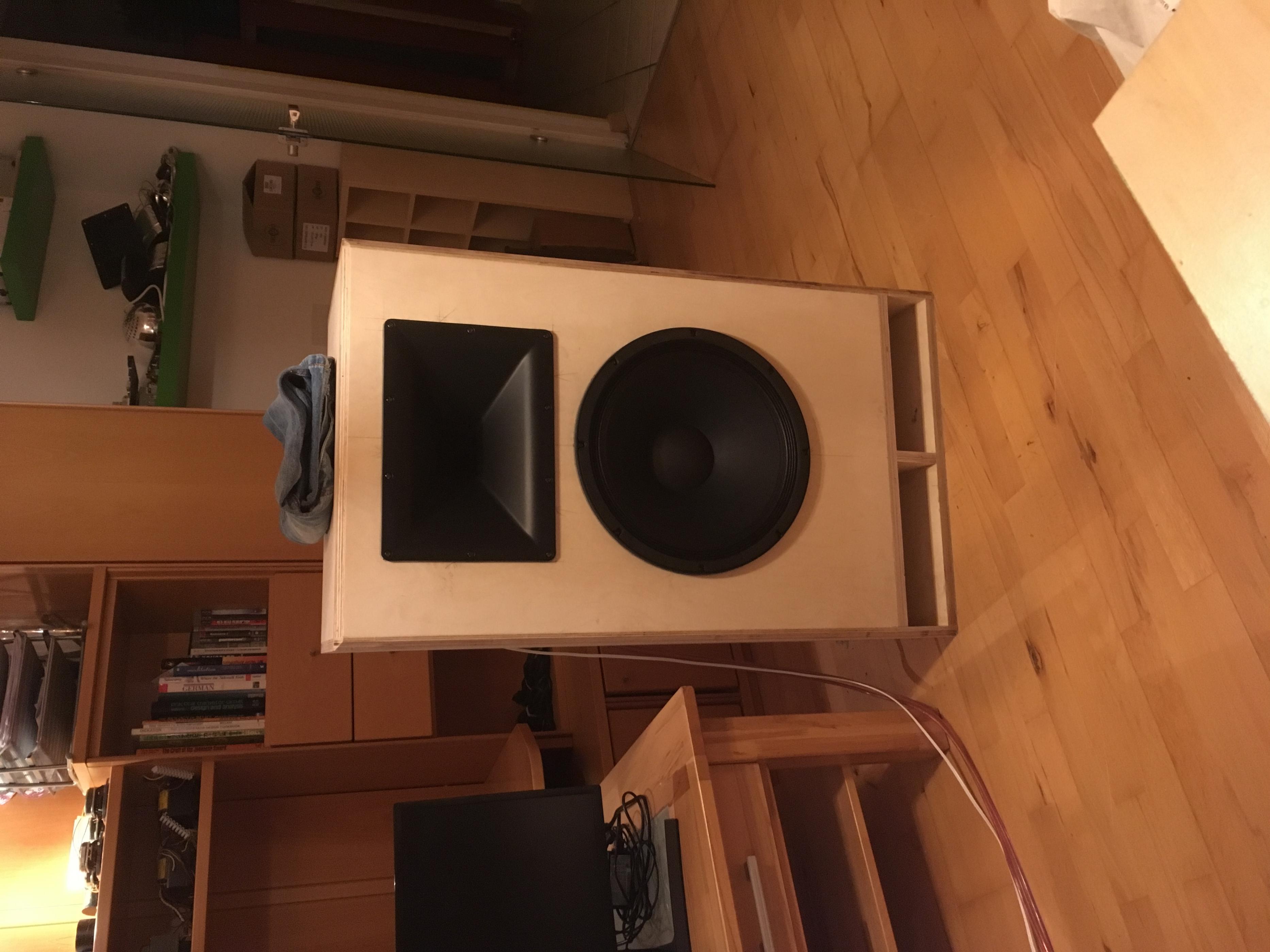

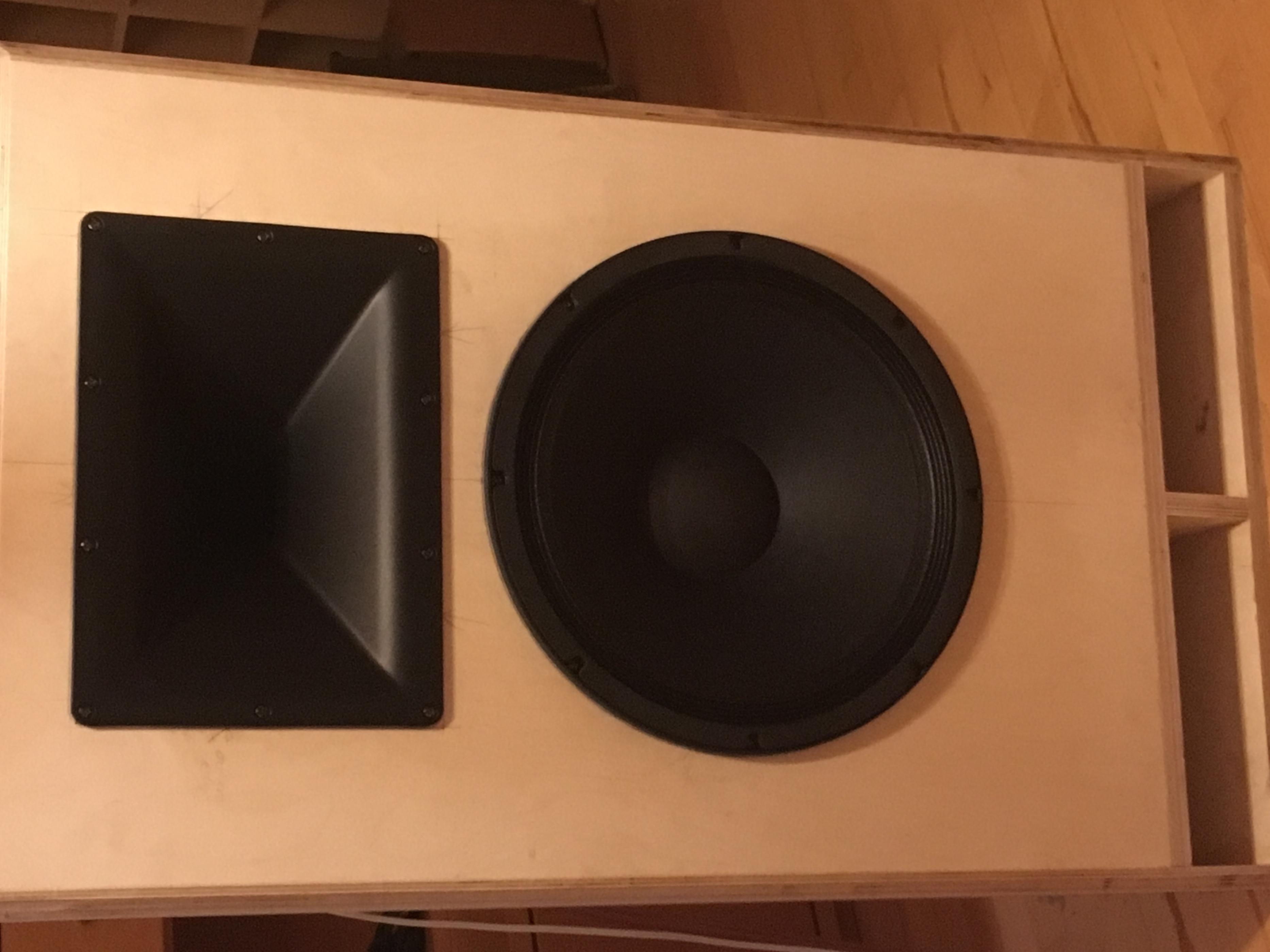

Indeed!! I went with the faitalpro and the QSC waveguide with the Denovo360 compression driver. All I can say is WOW!
They have dynamics uncomparable with anything I have built before.
I am using the MOD86 from Tomcr at the moment and it is more than enough to make concert level sound in my livingroom.
The FaitalPRO woofers are simply great, the build quality for the price is fantastic and the performance is also great.

I went with the larger enclosure (Happily Divorced) because I have the space now.😀
They have passive crossovers at the moment but a minidsp is planned for the future.
I am waiting until next spring to finish the enclosures, but i couldnt wait to hear what they sounded like so I went ahead and wired them up for the winter....

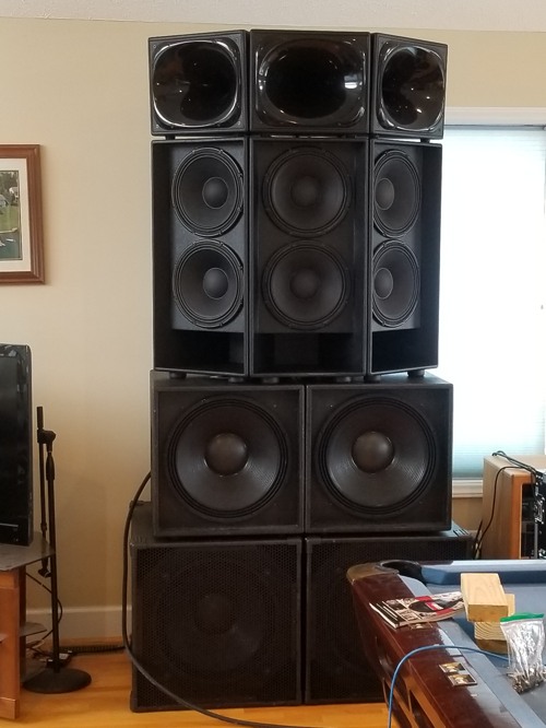

Hey, since i know you are into "hi-fi PA" too, here's the most powerful mains setup I've ever made...and uses xt1464's and 12"s 😀
Xover to subs is at 100-120Hz....I figure the mains stack needs the equivalent of at least 12 strong single 18"s to keep up.
Can I say L-L-L-LOUD !

Wow! I'd like to listen to Heilung on that setup 🙂
That's is a very nice top setup for a couple of hundred persons outdoors, it could potentially manage four figure crowds as well depending on venue type, what mids are those?
Cutting it down to one third would still constitute as self harm tendencies if used at performance level in a livingroom, I sure it sounds amazing at present levels though.
Thanks, this puts things into perspective, I will refer to this when people think I'm crazy with my home setup, haven't pushed the ROAR 15's (SW115 loaded) beyond a few hundred watts peak, it gets fairly unpleasant rather quickly, they hit ridiculously hard.
My standard cheeky answer is that true dynamic headroom capacity for 12 to 18dB crestfactor material does require a bit more then your average 6,5" hifi standmount can deliver decent levels 🙂
