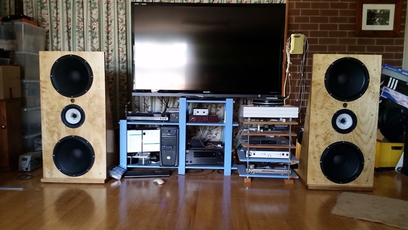

Maybe, Derek. The caveats you add are yours, while John's paper seems pretty solidly based on science and his conclusions about closed box vs ported speakers seems reasonable, I would give it more credit if he was explicit about assumptions and caveats rather than leave them for the reader to deduce. I didn't see any mention of WAGs in his paper, and even if he did - I might not agree. My WAG loves my OB speakers!!
Yep, that's 2 x 15" driver per channel Goes loud, and deep!
