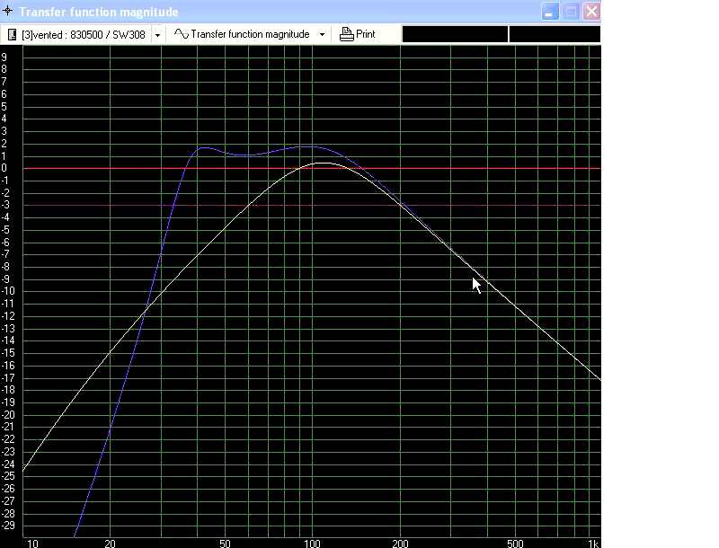

Now I am looking at other drivers that give me a more flat response, heck even exaggerated response below 60Hz is acceptable to take care of the bafflestep. I WinISD'd 3 drivers all in the same price rage of $150 per driver or so.
1) THe PPI Pro12
2) Peerless XLS12
3) Dayton Titanic Mk.III (12")
and got the following results... which one would you guys choose for the given application? Should I consider other 12"ers in this application with the enclosure around 1.9 to 3cuFt? In the same price range?
Unless your baffle is very wide, baffle step usually starts around 4-500hz and flattens out close to 100hz, so a peak at 60hz is not really going to address it. If you don't mind a peak at 60hz thats fine.
Out of those 3, I would choose the purple line. However, I would not port any of those drivers that high, may as well go sealed, at least then you won't be bottoming them with sub-30hz material all the time. If you really want them ported I would go with 1 12" a side, otherwise do 2 12" a side sealed.
If I choose the Peerles XLS12 (Purple plot in the previous image) and go with the sealed version, I get these 2 plots:
Purple = vented
Yellow = Sealed
Both 1.88cuFt... the sealed does not look very promising here.

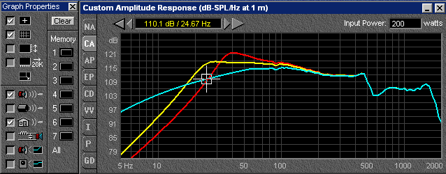

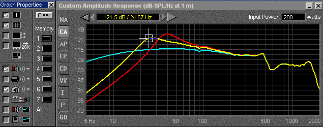

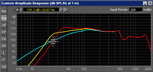

OK there are 3 sets of graphs below. All of them model one driver in 1.88 cu ft, with 200w input power. The effects of your crossover on the response is not simulated.
In each graph red line = your ported box, blue line = sealed box, and yellow line = your ported box, but port extended to 27" (tuned to 24hz).
The response is all 'bumpy' not because of the modelling, but because this driver was already in the bassbox pro database with real measured response.
This first graphs is anechoic. This is very similar to what winisd is giving you. But you need to consider room gain as well. I'm not sure if you have an idea of what the gain in your room is like, but the next two graphs will have room some arbitrary gain factored in to give an idea.

Thanks morbo, in the first pic (red line) what did you choose the port dimensions to be? I can either do 4" D with 5" length or 10" length as these I already have installed.
I don't have an idea of my room gain, but the sealed plot with room gain looks sweet!

Some random info/thoughts
Assuming 200w input per driver:
- your ported design exceeds xmax below 25hz, and excursion goes up very fast below that
- your sealed design exceeds xmax below 23hz (but, the cone is still under control by the 'air spring', not unloaded like the ported one, and excursion inscreases more gradually)
- the adjusted ported design exceeds xmax below 19hz, and excursion goes up very fast below that
- both ported designs exceed 20 m/sec vent velocity, yours peaks at 30m/sec @ 35hz, the adjusted one peaks at 24m/sec @ 23.5hz.
You said you are crossing actively... you don't by chance have an extra highpass section that could be used as a rumble filter maybe? Because that would open up some nice possibilities.
