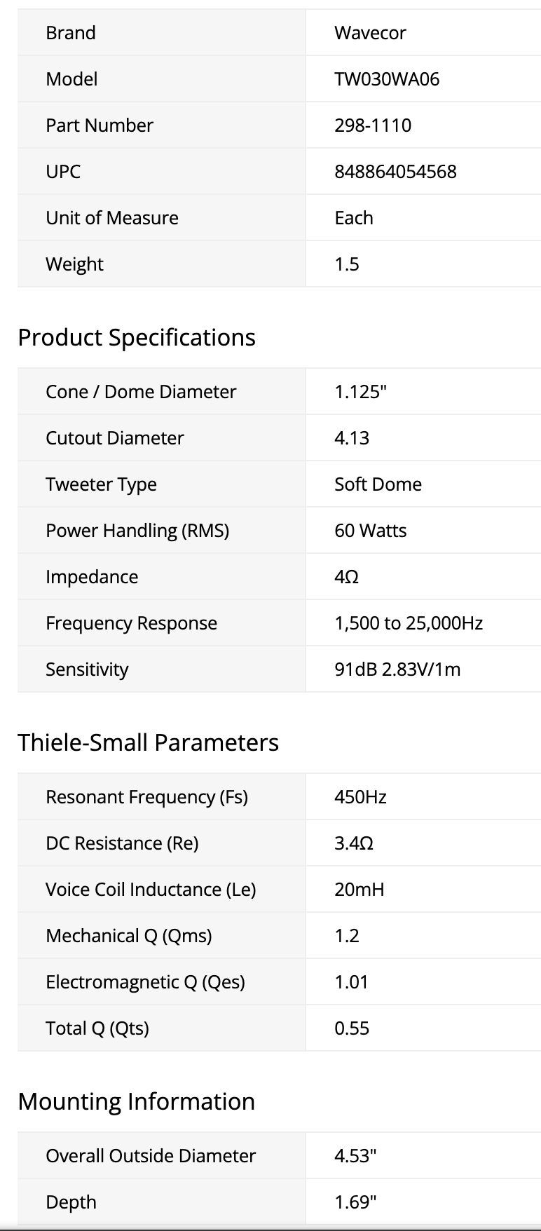

Where would you cross this tweeter
I'm trying to cross as low as possible in an active open baffle speaker. I'd like to try two way but I have the means to do 3 way if necessary. that's what I have now with GRS 15" woofers and q100 Coaxial driver from a KEF Speaker.

Oh, you mean the Wavecor. Honestly I would not directly cross that to a 15" driver, especially that GRS! That would be a very bad idea. I once built a nude OB system that crossed a very nice 15", the Eminence Deltalite 2515, to a back-to-back pair of Dayton ND25FW tweeters wired to operate as a dipole and crossed at 1.6kHz and it worked pretty well all thing considered (I used some serious DSP to do it). There was a separate M-frame below 150Hz, so 3-way.
If you really want to make it a 2-way, use a 4" fullranger as a tweeter with limited HF extension (for example people use the ScanSpeak 10F4424G00 in that role). Otherwise a 3-way that combines the tweeter with a 6" midrange like the SB17MFC or CAC. The coax approach and the mid+tweeter are OK but the pattern will change from dipole to forward-only radiation when the mid cone no longer radiates to the rear nicely. This will create challenges with the tonal balance "up there".

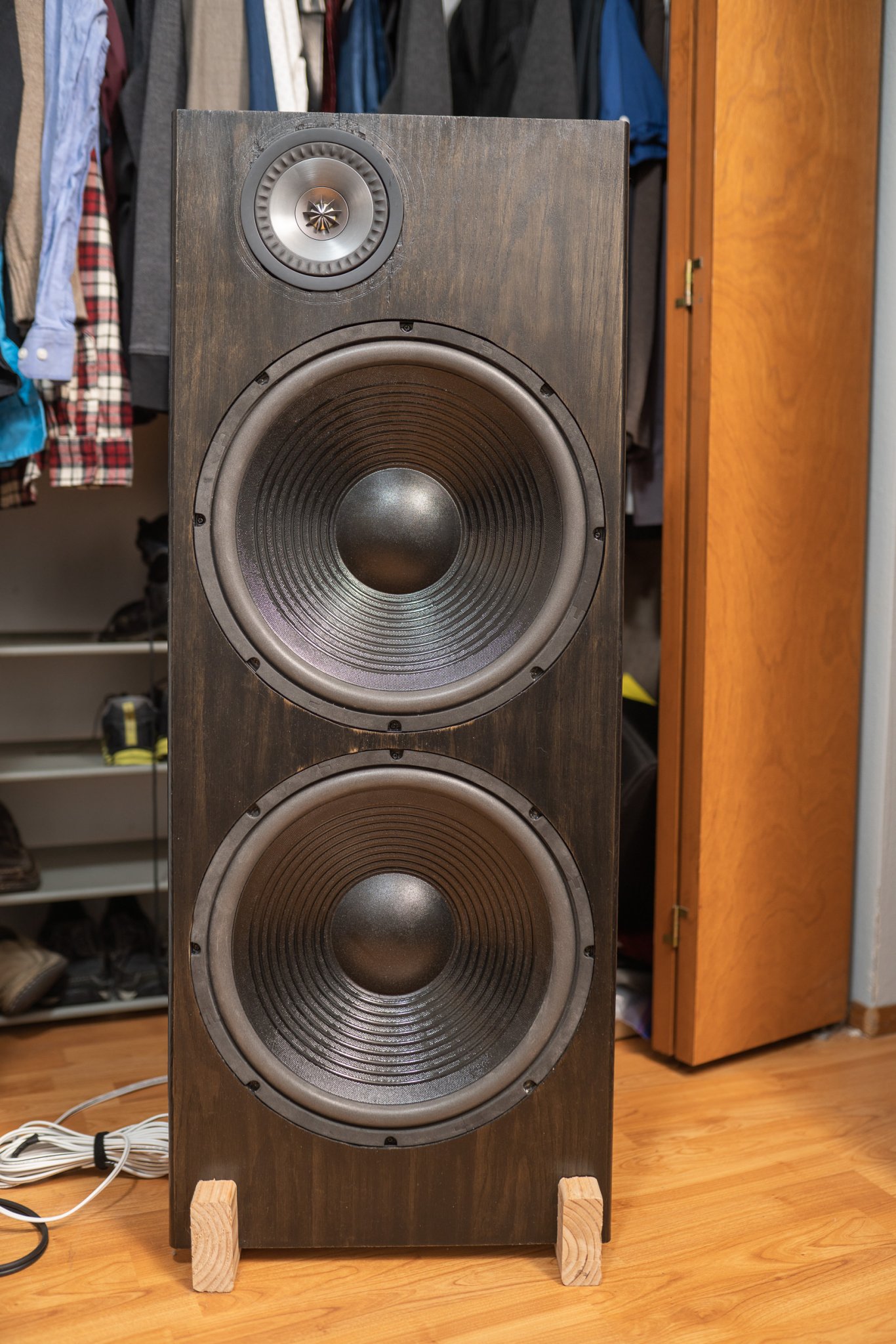

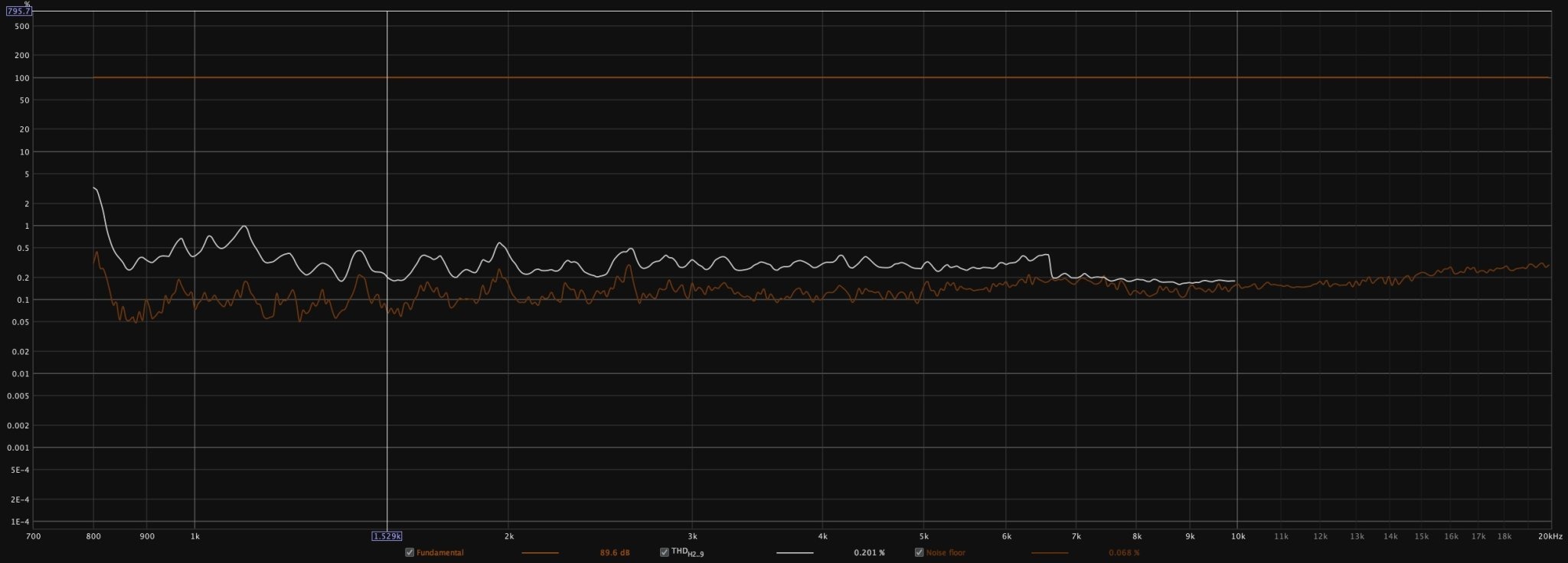

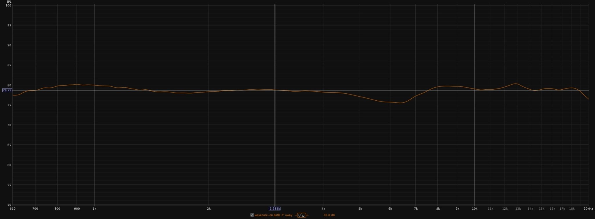

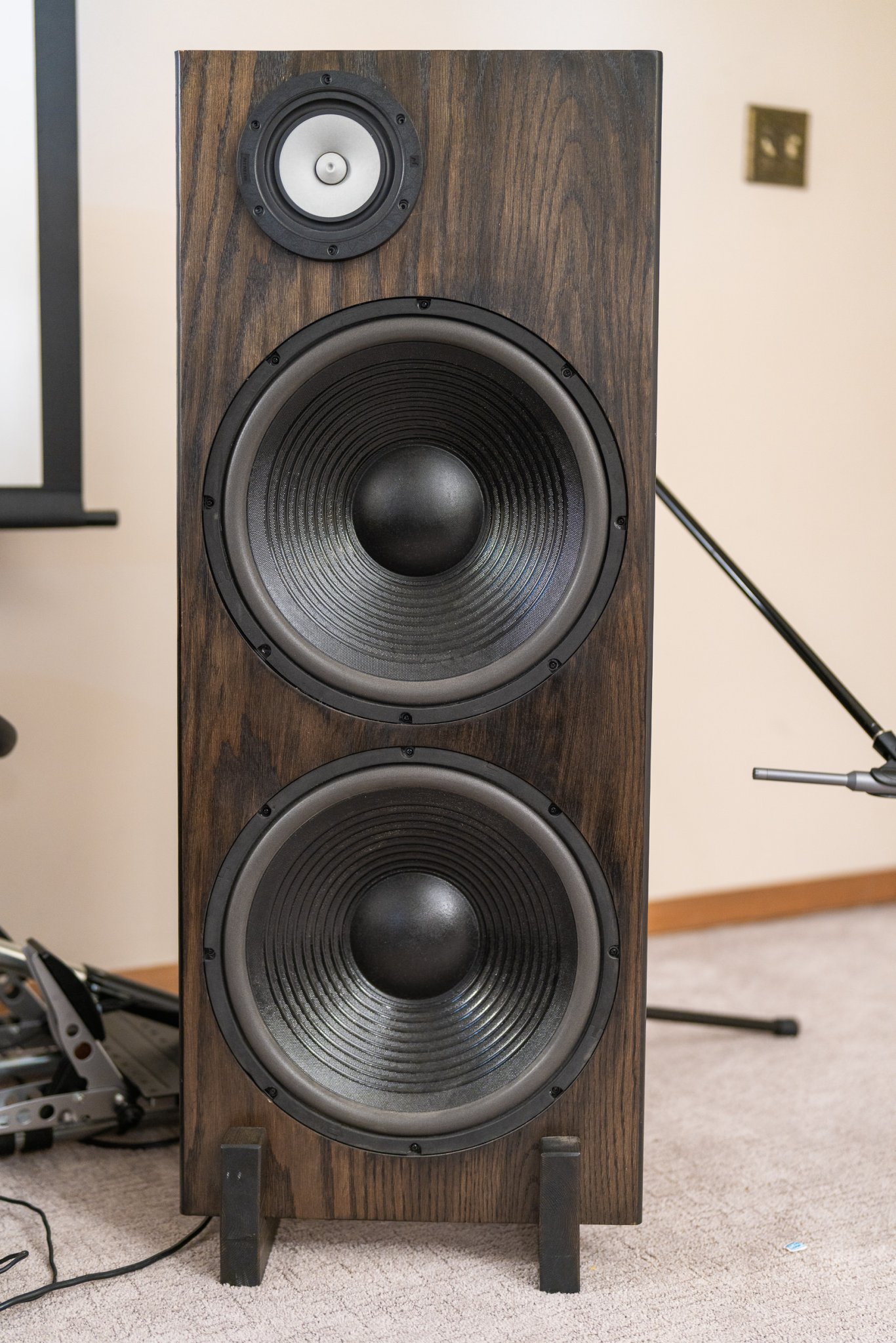

Hahaha, you had some good ones in there!!! Yeah, I think I’m kidding myself with the two way option. Tried a 6” full ranger for a while in top end and didn’t love it. Measured the response and found out why…. It was fully dipole that way which was cool but just didn’t love it.
So I went back to my original kef q100 design and there is something I don’t like about the top end of that speaker either. Even in the enclosure there was something it was missing. This is of course active with eq on both to being the response into line.
Maybe I just need to add the full range back and put it up high as the midrange driver. Its response in midrange wasn’t too bad.

That specific tweeter can be used down to about 1.600Hz in a high quality two way without any problem.
As with all chassis, the distortion increases the lower you cross, so the max SPL level should be lower. As always... These are quite basic things about speakers, if you want loud or lower distortion, just X- it higher and/ or make the X a higher order. Finding the sweet spot is a large chapter in the magic book of speaker building.
Some combine such 15" woofers with a small horn speaker from 3.000Hz and like the sound. Depends on driver and music material how well it may work.
If you want high quality, don't use one of the cheapest 15" around do the work of a mid frequency driver.
A compromise would be a 2-way DSP or 1/2 active construction, using a decend mid plus tweeter combination with a passive x-over. This way you can correct the baffle characteristic, room influence and any problems of the passive 2-way branch as well. So you are on the right way IMO.
Any open baffle woofer should be done with a DSP and separate amp anyway, as the passive version with neccesary level corrections will usually be worse and more expensive.
If going 3-Way active will improve anything may depend on the amps used. In most cases there is no problem to do active as well or better than passive.
