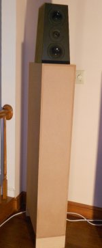

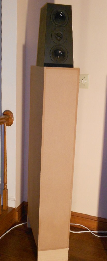

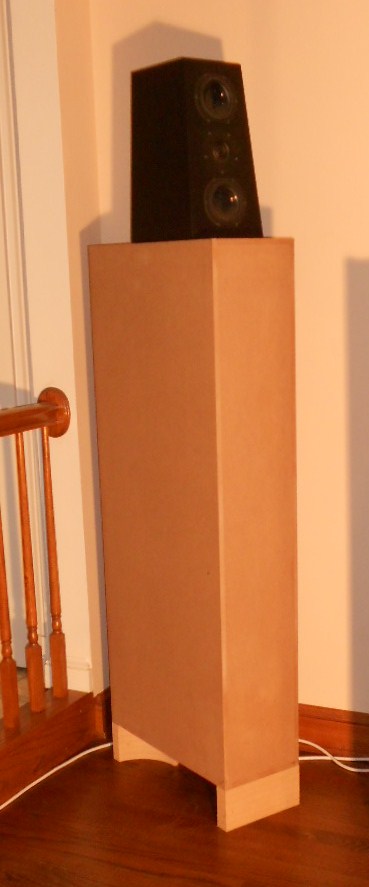

Some very good points Silent. Here's an example of a thin line sub (9" which wasn't a design goal). Btw, they cost less than a tank of gas to build and rattle the floors and walls.
They were designed here on DIY - and again thanks to the engineers!!
I'm a huge fan of smaller speakers that sound great, AND do not cost a lot.
The top speakers is Madisound's HDS kits, great for surrounds, sides, etc.
