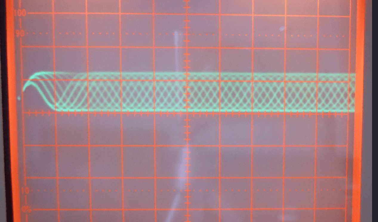

Disc clamps are magnetic and just 'drop' onto the top of the disc and so if the clamp itself looks not centred then that is absolutely normal.
The edge of the spinning disc should run 100% true as viewed from above and equally important it should run true in a vertical direction as viewed edge on at the disc edge.
Next check if the mechanics look OK is to look at the RF from the disc on a scope and judge whether the amplitude is OK and also the overall Q or quality. Amplitude is typically around 1.2 volts pk/pk for a Philips based player:

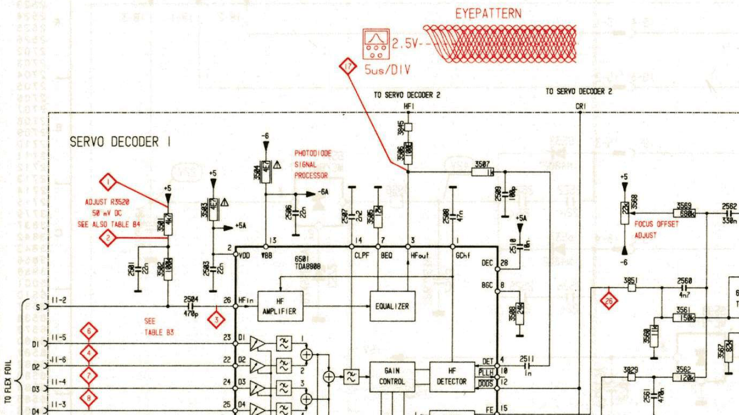

Where am I looking for RF and Q? Should there be some sort of diagnostic pad setup or something?

The RF is picked up here on these resistors and on a suitable scope should look as stable as the picture in my earlier post. If you can manage to look at the lens while it is playing an outer track on a disc (use a torch and look horizontally under the disc) then the lens should be relatively still. If it is moving up and down then that means it is focused on a disc that is also moving up and down (dirt on the platter can do that). If it is wobbling side to side then that is following an eccentrically running disc. Movement in both axis should be minimal for a disc running true and level.
The RF shown here is stated as 2.5v peak/peak, the value I gave of around 1.2 volts would be that seen on pin 26 of that chip where it says HF in and before being amplified. The 2.5v is the one to measure as it will be easier to get to on those resistors.
