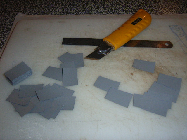

Well, given the inability of me to get an insulating sheet, I've gone ahead and isolated the heat sinks which are sitting at -35 VDC, chips mounted with the Arctic Silver compound which I think we have confirmed is electrically conducting under the high pressure from the clamps holding the chips down here.
Endzedone, want to cut me a piece good for about 10-12 chips?

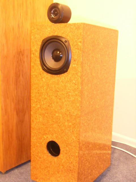

I have been busy trying to finish some little speakers that have been sitting in my garage for nearly a year collecting dust.
Once the other is complete it's back to the amp
poobah said:Kapton works quite well in fact...
Needs a bit of grease though on the non-sticky side.
sticky side?
