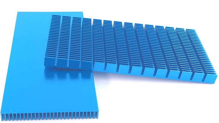

Would this be suitable?
https://www.mouser.ca/ProductDetail/Wakefield-Vette/567-94AB?qs=f9yNj16SXrLfZWY%2BuxfB%2BA==
http://www.pmillett.com/images/DCPP.JPG
Either of those two heatsinks pictured should work fine...but take into consideration you would be layering two hopefully flat structures on top of each other, some additional screws might be in order...& use lots of heatsink grease between the two.

YES, that would be so cool !! I'm guessing the "fins" as pictured are only some 13mm high & not that efficient at removing heat...as such, using more "area" to compensate will work fine.

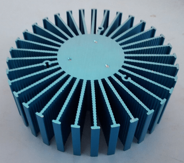

Lots of heat sinks are designed for forced air cooling, including the blue ones shown above. If you're just looking for a little bit extra heat sinking they'll work well even with convection cooling (and likely horizontal fins in OP's application).
Some may geek out over the colour and point out that black would be better. It would ... but not significantly better than other colours. The most important thing is that the heat sinks are anodized rather than raw aluminum. Anodization increases the surface roughness (-> area) which results in much higher emissivity than raw aluminum.

Depending on the diameter of this circular heat-sink, an identical twin atop...radius the top fins to approximate the shape of a tube ??

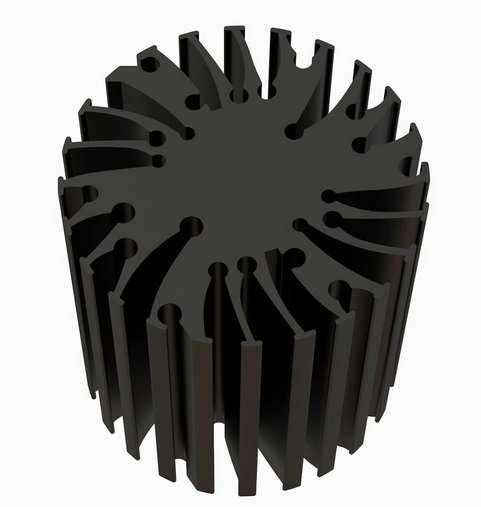

Add a little riser/heat spreader underneath and you might even get decent airflow across that heat sink even if it's mounted to the top panel.Don't settle with boring rectangle black heat sink, perhaps this one will make the tube amp look more aesthetic.
