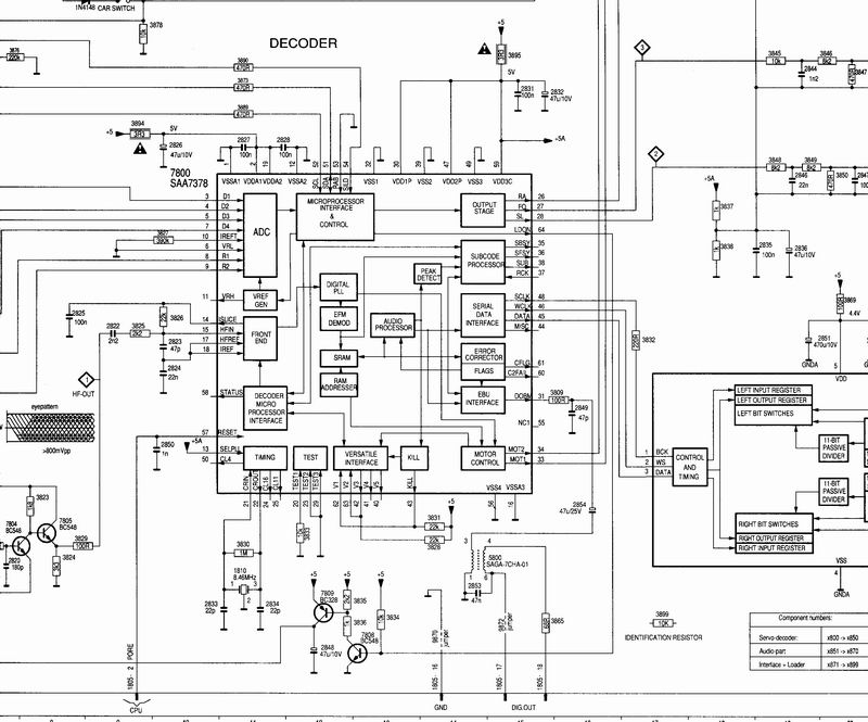

What is this schematic? If it is the Philips CD723 or CD753 schematic can you send all for me ?

Any idea where to find the datasheet for the SAA7378?
Heiko
Hi
I have the PDF, about 200k, 45 pages
Mail me at
Info@TENTlabs.com
with SAA7378 in the subject, if you want a copy
Ciao

Heiko said:Hi!
Heiko
Hi !
Hope this helps you:
http://www.jobstens.dyndns.org/area0/saa7376_2.pdf
The Pinout is the same
Regards
Jobstens
Thanx to Guido for the Datasheet
All other can download now here:
http://www.jobstens.dyndns.org/area0/saa7378.pdf
