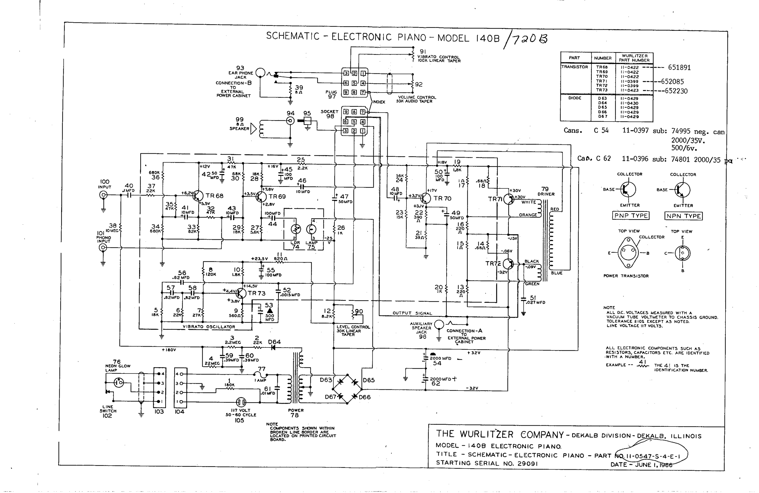

Where to find a suitable driver transformer?
Been looking for a 1:1 center tapped secondary transformer suitable for the attached amp schem. DC resistance is roughly 100ohm primary and 8ohm each secondary. Its a 30W amp for a wurli. The driver transistors are germanium type dgt-110 or sk3717. Ant help would be very very much appreciated.
