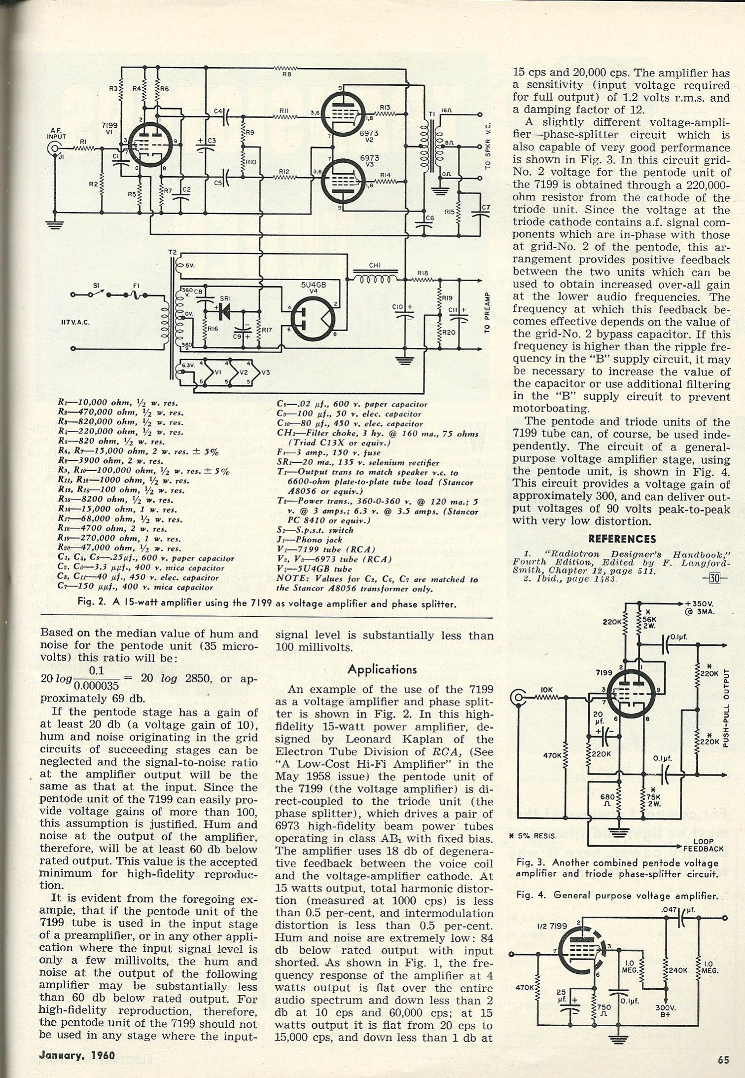

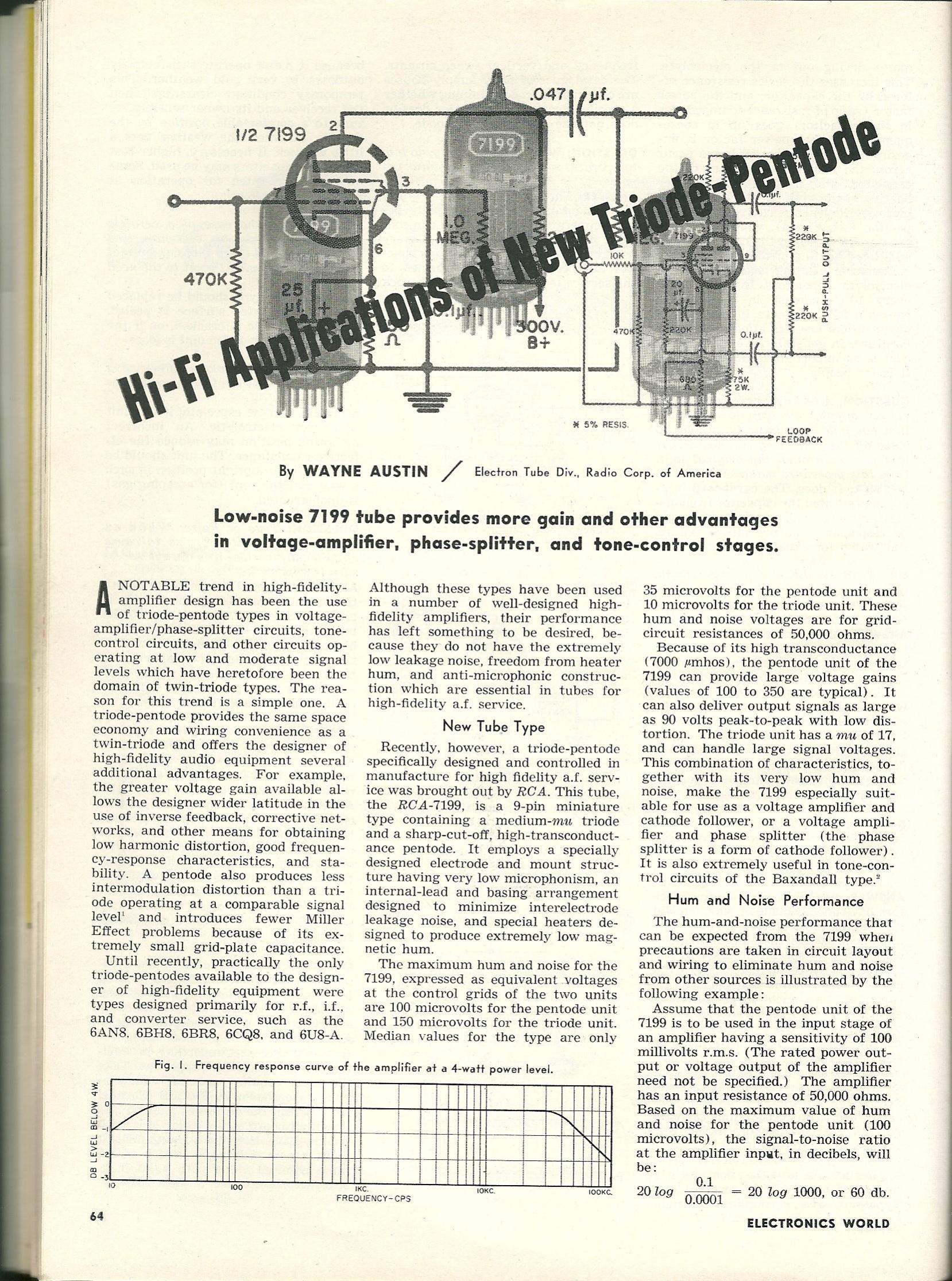

Here's a curious article about the 7199.

Using a DC power source for the heater should fix the hum issue for most input tubes. Higher gm leads to lower internal tube noise, so a high gm pentode (6F12P, 7788, 7722, 7721, 6JC6, 5/6JK6) should be quietest. (microphonics could be an issue with high gm however) The 7199 linearity is rescued by the small signal level coming into the pentode typically.
One interesting possibility to eliminate microphonics would be to use a dual identical pentode (in one bottle like 6BN11, 6J11, 8CB11) where each identical tube section would have identical resonances (testing required obviously) and a differential gain stage would cancel those out electrically. Differences in lead in wiring could mess up the identical resonances. 8CB11 and 6J11 are similar dual pentodes with different pin-outs. Dual triodes (fewer elements to shake) might have better luck getting cancellation.
