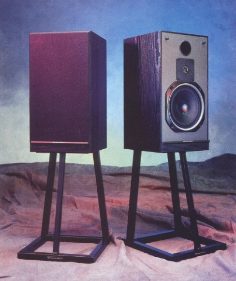

Mordaunt Short offered a matching open frame stand for this model and its contemporaries.
The MS stand could be bolted to the screw fixings on the base of the speaker.
Such bolting is safe and convenient, but not necessary. Other stands of an appropriate height may be used.
I may be able to attach an MS brochure showing the matching stands.
This is what the dedicated stands look like:
It's important to select stands of the appropriate height to ensure the correct driver positioning relative to your ears when seated.
Here are the dimensions of the MS35Ti stand to help you search for a suitable alternative:
Stand model IS2: Height 422mm; Mounting Base Dimensions 310mm wide x 325mm deep.
P.S. M4 bolts screw into the inserts pre-fitted into the base of the MS35Ti.

Oh! Just when you thought I'd gone, here's a correction!
The Mordaunt Short IS2 stand dimensions of 310 x 325mm are not the top mounting base dimensions, but the bottom base dimensions.
The base dimensions of the MS35Ti speaker are 260mm wide x 275mm deep so the top plate dimensions of the Atacama SLX 400 stands (225 x 225mm) are a good match.

Mordaunt Short recommend "at least 14 inches from the floor" and their dedicated stand is 42.2 cm (16.6") high. Go higher and you will encounter stability problems, as I will elaborate on below.
The size of the top plate affects the stability of the speaker on the stand. Before purchasing stands, check the size of the top plate and compare it to the size of the base of your speakers to ensure there’s good coverage.
In addition, the wider the base of the stand, the more stable the arrangement will be.
The bottom base of the stand should not be smaller than the base of the loudspeakers - the base of the Mordaunt Short IS2 stand is 1.2 x the base dimensions of the MS35Ti.
Stands suitable for a bulky speaker like the MS35Ti are harder to find and that's why I pointed you in the direction of the Atacama 400 to let you see the design of stand you would require. Atacama SLX 400 Speaker Stand Stands (Pair) - Black

I have two brochures for the MS Series 2 speakers.
MS supplied two different frame stands for the MS35Ti.
The earlier one was the "High Definition Frame Stand"" of height 46.5 cm.
The later one was the "IS2 Frame Stand" of height 42.2 cm.
Michael, do your stands have a "Mordaunt-Short" badge on them?
P.S. There was also an early, low cost "Pillar Stand" which was the model I returned with my MS35Ti speakers. It was 38 cm high!
