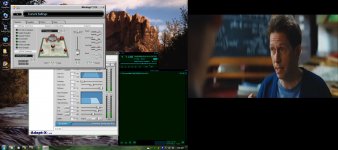

Here, (below - R is HTPC/ left is panasonic 37" LCD) is pix of what I have had (3700 movies/120,000 songs) for 5 years.
Pix of the actual system is in "my stuff" (ostripper)

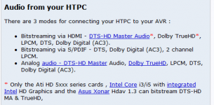

Forget PC soundcards ie low level single ended analog signals and PC noise floor issues is a nightmare. HDMI or optical with an external audio processors is the way.
Also agree with most 'colwaiting' thoughts.
start here look for HTPC Audio Windows 7 Media Center : Setup Guide, Knowledge Base & Support - AVS Forum
