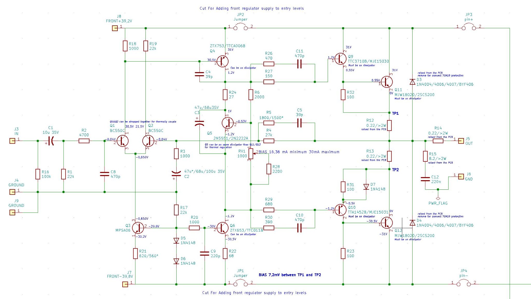

Hello, I'm currently finishing a new amplifier, but unfortunately this time I'm having a ground loop problem between the two channels.
When I finished the first channel, I didn't have any hum in speaker. It was when I added the second channel that a hum appeared, and I was able to test, as indicated in this document, that this was indeed the problem.
https://hifisonix.com/wp-content/uploads/2019/02/Ground-Loops.pdf
I was able to improve things by modifying my wiring, but a slight hum persists
in the test speakers.
I'd like to add this Hum Breaking Resistor (HBR) if possible, but I admit I'm not sure where to place it.
Here is the amplifier schematic:

I think so..i call it Groundlift. Diffcult for me, i have to learn....clean ground, i call signal ground, dirty ground i call powerground..but it is the same.
The 10 ohm resistor splits clean ground from dirty ground.
R10 is my groundlifter...yep

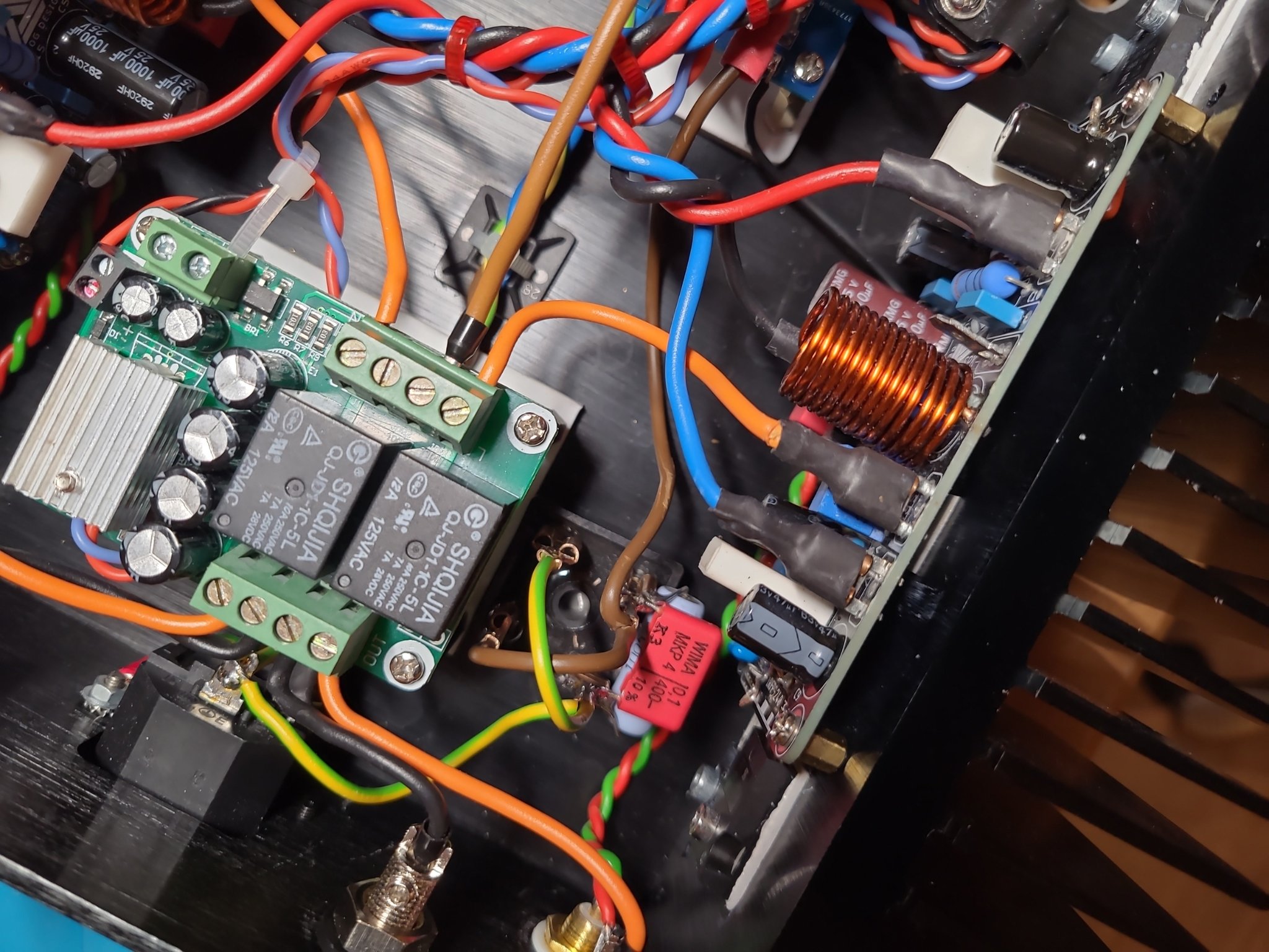

I had overseen, that you always know the pdf of Hifisonix, about ground loops. Let me ask how you connect ground and earth together ?
I use a loopbreaker https://sound-au.com/earthing.htm
Another way was to use an 10 Ohm resistor (with paralleld capacitor), but with the diodes in the recitifer is the better solution, more safety.
The chinese spaker protections have paralleld connections for the speaker minus . Sometimes it is better to use one bigger wire from starpoint and split behind the speaker protection....(if you use such a protection).

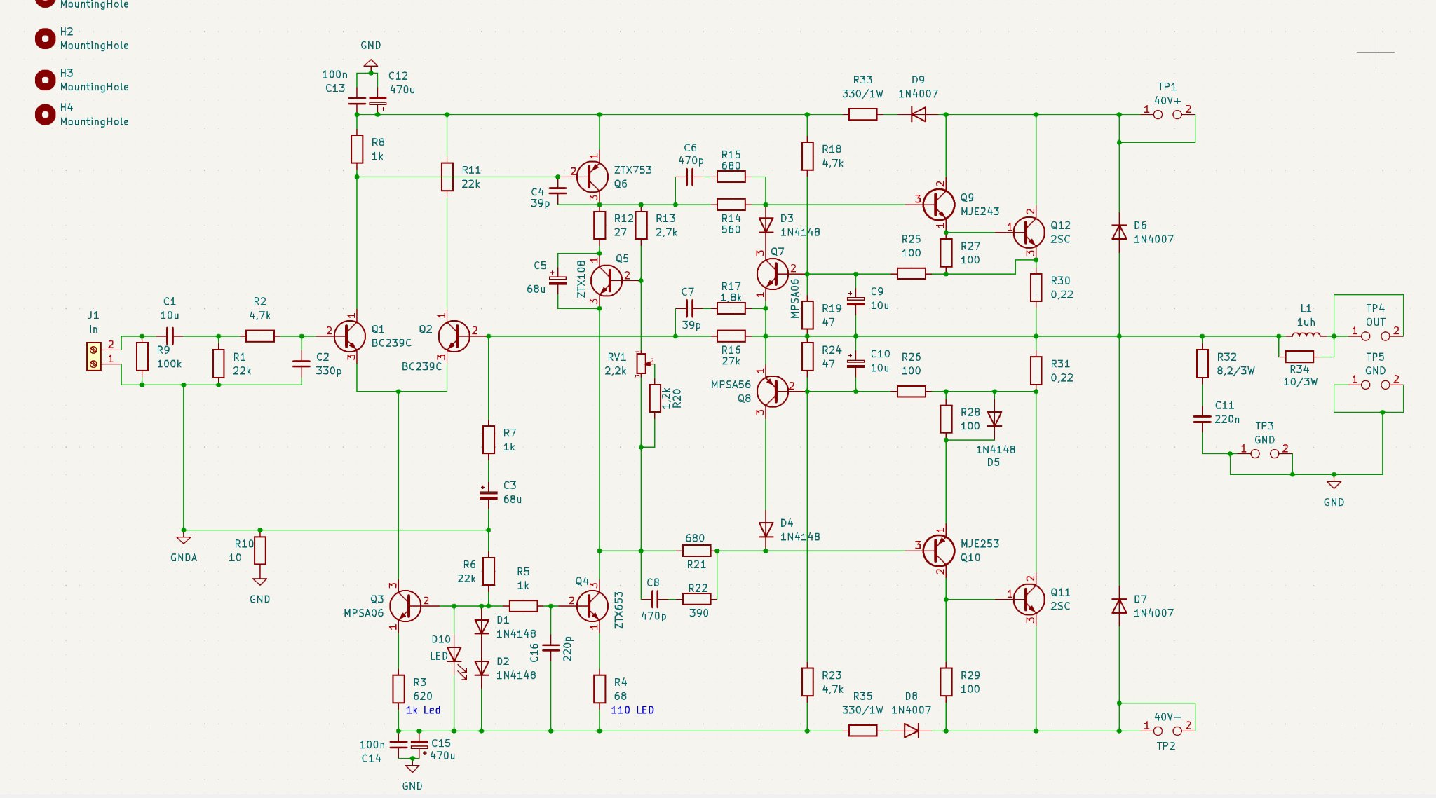

Tying signal ground to power ground through a resistor near the input seems like a common practice.
But I have another question: I’ve seen designs where the ground reference in the feedback is tied to signal ground. That makes me a bit uneasy, since it could potentially put DC across the speakers if the two ground deviate too much due to something funky being plugged in at the input.
What’s the smart people’s take on that?
I used it in the 2 boxes for my active speakers. One box for left, one for right, 4x LM3886 in each box. No hum.
There are 4 cinch inputs isolated from the chassis. All 4 input cinch connectors have their shell terminal connected together on a pcb. At that point the cinch connectors are isolated from the chassis. That common "input GND" is connected to the chassis at the same point as the mains earth input.
From that pcb there is a little coax that goes to each LM3886 board that has a local GND plane. The shield of the coax is connected to the "input GND" of the cinch board and at the LM3886 board GND plane. On the LM3886 board this GND plane is used for the feedback, input filters and LM3886 GND pin and it is connected to the star point of the psu. Each LM3886 board also has a V+, GND, V- connection to the psu but this GND is only used for the bypass capacitors. The GND of the speakers goes from the speaker terminal directly to the star point.
