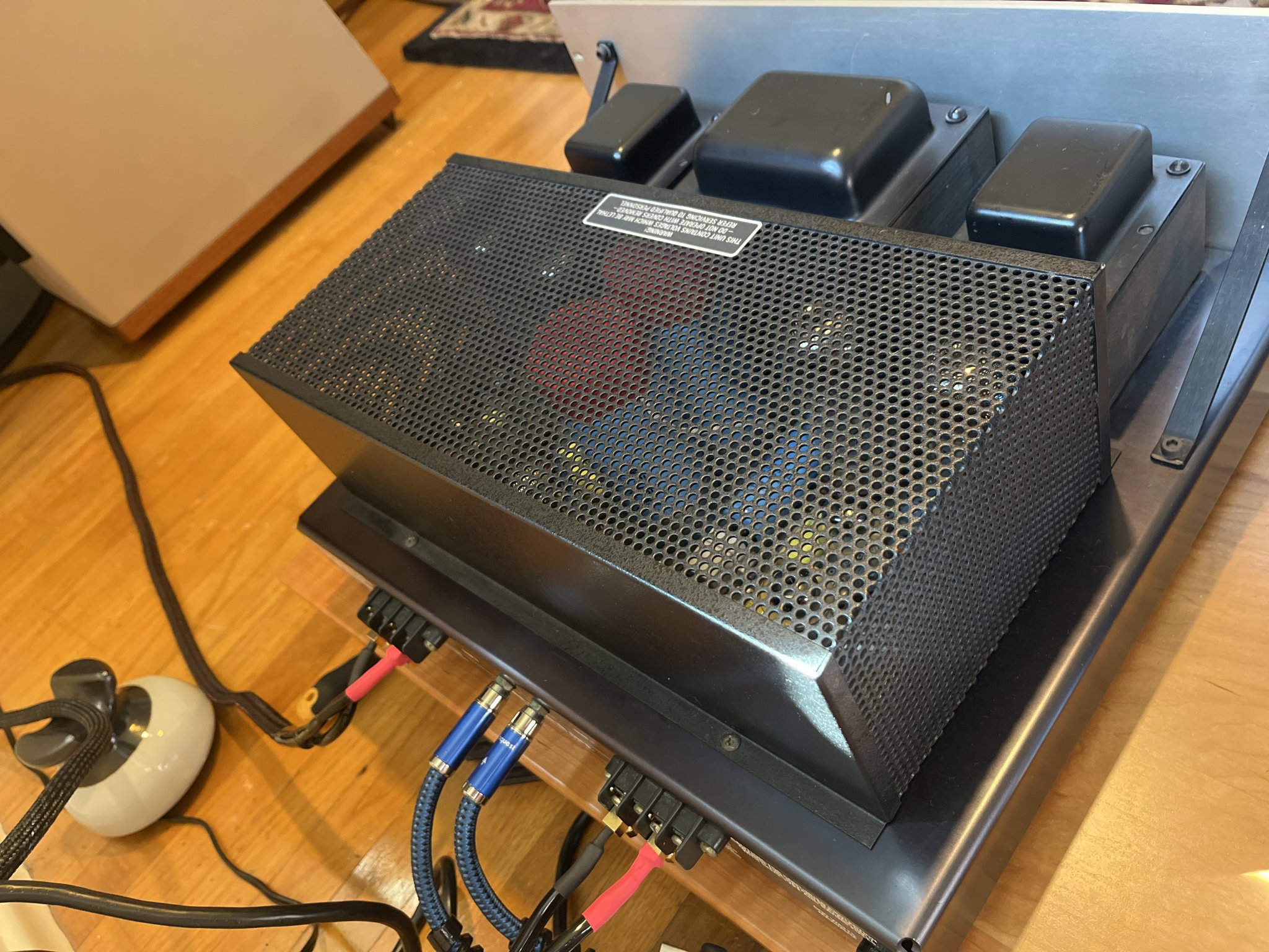

Back is completely open. Front is somewhat constrained, but should have a good 1.5” gap around the sides and the top. My initial idea is to place vent fans at the top corners behind the amp.
I would prefer not to modify the cage, but perhaps mounting fans on the top could work? Either blowing up, sucking cool air in from the sides, or blowing down, forcing air over the tubes and PCB and out the sides?
I’ve ordered an AC fan controller that can drive up to four PC fans with variable voltage control, as well as a four-probe thermometer. As long as I can keep the noise down, I’ll throw as many fans in there as I can fit.
Picture attached for reference. I could also run without the cage for additional airflow.

The electrolytic capacitors are the weakest point.
I wouldn't worry about the tubes with the cover off.
But the output tubes generate most of the heat, so you want as much of that as possible
to go right up and out of the amplifier. Some heat will still be conducted to the socket and board.
The goal is not to cool the tubes but get the hot air out before it cooks everything else. The cage will literally make a fan blowing on it worthless, air takes the path of least resistance so it will hit the perforated metal and spread out but very little will go through. Mounting fans on top of the amp bolted to the perforated metal sucking air out will help the most. There will be a lot of resistance to flow because over half the area will be solid but a good fan will suck out more than would normally just flow out from convection alone. Two fans, one over each channel would work.the larger the fan the better. 8” fans are available in both 120 and 12volt you might even want to block off the holes on the top and upper sides of the cage to force air from the bottom up through the whole amp. The path of least resistance again, if the air can cheat and avoid going a long way it will so instead of being drawn across the whole amp it would just be sucked in right next to the fan on top. Blocking the holes in the non fan area would force the air to do what you want, pull the hot air out through the amp.
