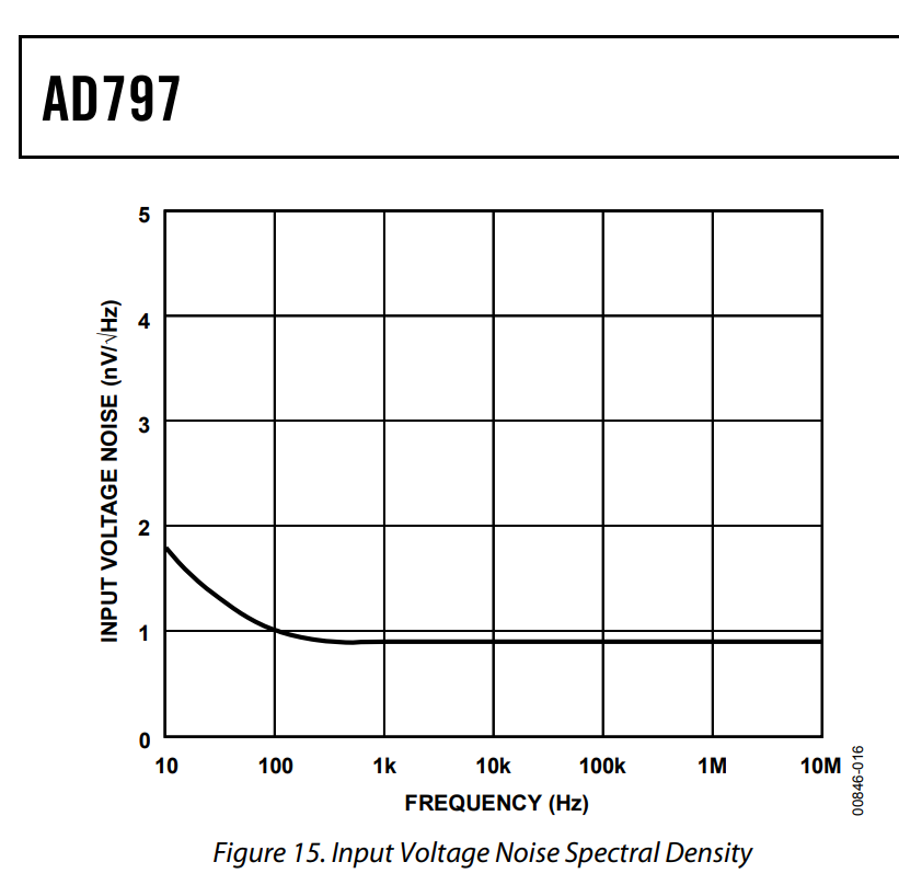

around 600 nV√Hz.
Is that a typo? "Good" numbers are single digit nanovolts per root Hertz. 600 has three digits.
