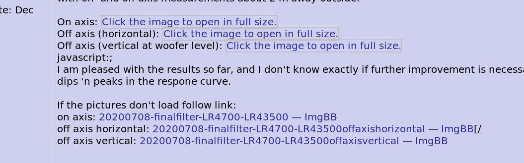

After a day of hard work, using the methods described above, I ended up with 139 us delay on the tweeter and 21 us delay on the mid (@ 1.5 m distance).
Measuring outside I ended up with a crossover (LR 4th order) at 700 Hz (WM) and 3500 Hz (MT). This xo produced consistent results with on- and off axis measurements about 2 m away outside.
On axis:
Off axis (horizontal):
Off axis (vertical at woofer level):

I am pleased with the results so far, and I don't know exactly if further improvement is necessary. I learned not to address to many dips 'n peaks in the respone curve.
If the pictures don't load follow link:
on axis: 20200708-finalfilter-LR4700-LR43500 — ImgBB
off axis horizontal: 20200708-finalfilter-LR4700-LR43500offaxishorizontal — ImgBB[/
off axis vertical: 20200708-finalfilter-LR4700-LR43500offaxisvertical — ImgBB

Hello Geert,
Just out of couriosity and with all due respect for your work:
What was the off-axis angel you measured at?
It appears to me as if the 200-320Hz and the 410-520Hz "on-axis Mountains" may cause sound coloration. Were you able to verify or falsify this by your music listening tests? If verified, what's your plan?

Good question, I've actually adjusted my filters a little bit and it's more smooth, also off axis (I think I measured a few times at 20-60 degrees.
However, I'm seriously considering lowering my Bass-Mid XO to 350 Hz (as originally used by B&W). I'll post pictures of the flattened response of the mid and bass driver soon and ask your opinion on it.
