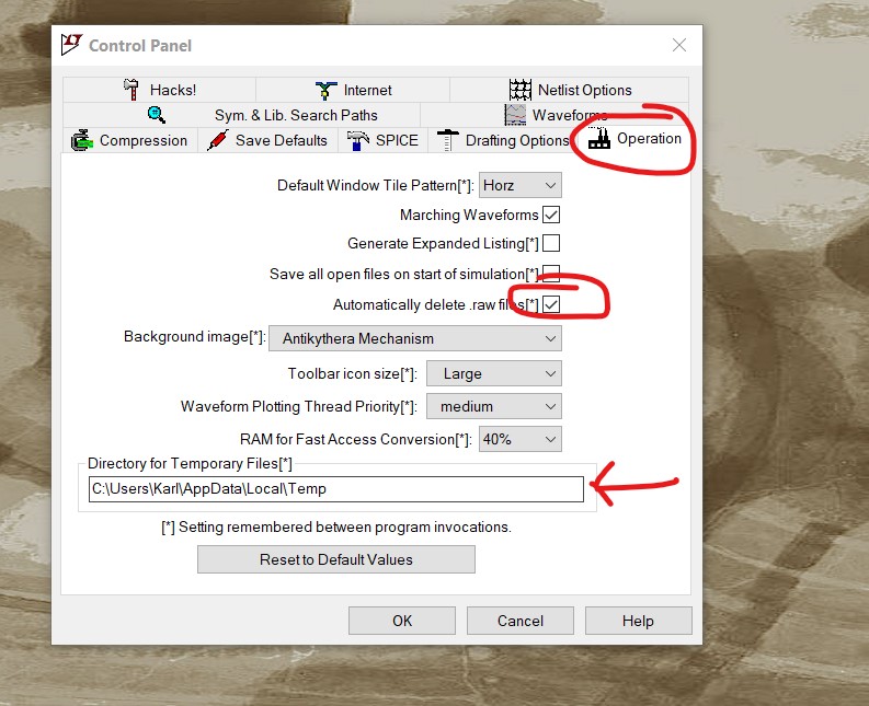

In the preferences, there is an option to automatically delete these files when you close a simulation. I believe that is the default, but you can set it to leave the .raw file alone for post processing using other software such as MATLAB. FWIW, I have left those preferences as the defaults, and I have no .raw or .log files to clean up regularly.

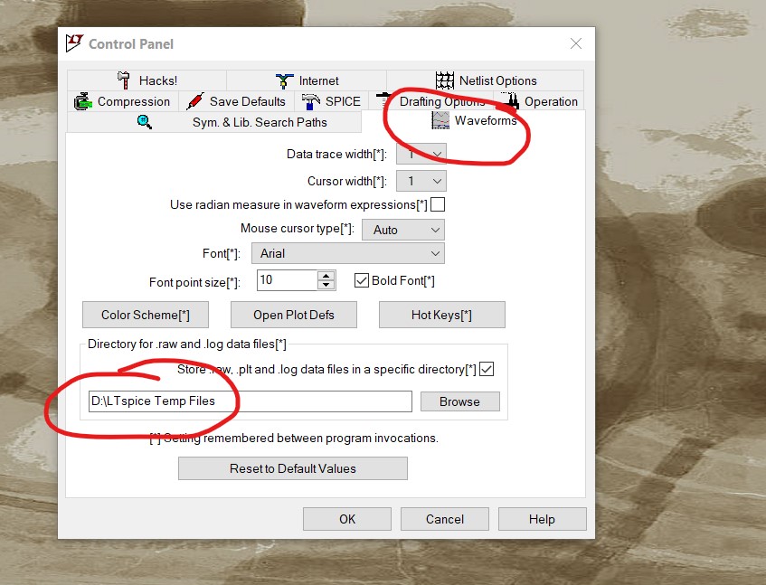

If you look in LT's control panel you will see the default locations.

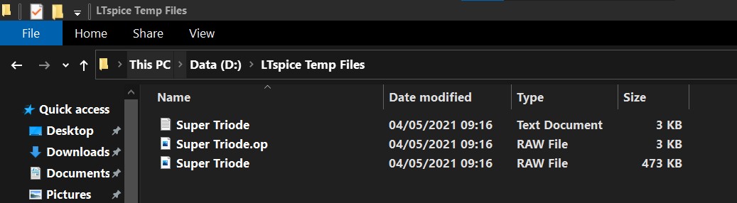

I have LT set to auto delete .raw' files as these get very large. The files generated during a simulation can also be placed in a user defined folder as I do. When a sim is run the three files you see are created. When you close the sim the files auto delete.
Be aware that on W10 you can find your own file location can be reset to the default following a W10 major update. Its annoying and you don't realise it has happened... not that it makes much difference... I just don't like what can be Giga Byte files for super long sims be written to the C drive.
