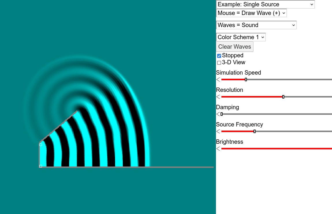

People used to use rules of thumb. You can see this when you use hornresp and change between radiation spaces. While the calculations are correct per se, they aren't intended to represent removal of individual walls in an arbitrary way.
I don't know what simulator you are using but it's not clear that it is doing the kinds of simulation I'm thinking about. Perhaps if you did a ripple tank style simulation, covering both the high and the low ends of the band, with and without complete wall support etc... and then made a personal judgement as to what lengths to use?
