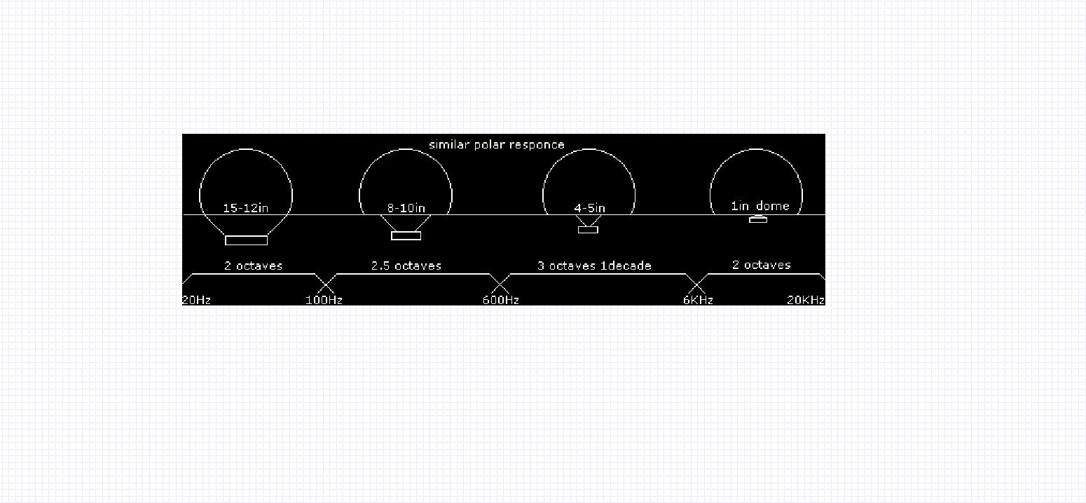

In my opinion, there is no driver that can play bass and quality midrange at the same time. I abandoned my attempt at an Econowave a long time ago. Can you cover 5 octaves with a 12"?? In my experience, no. I have come to appreciate that the music lives in the midrange and covering 2-1/2 to 3 octaves (400 to 2400) yields the best results. Finding the 'elusive, ultimate' mid-range is my goal. One of my concerns with DIY is always chasing the next 'new' thing. I always go back to Lenard Audio articles on drivers and what they cover effectively. But it is fun and interesting to see new ideas.
