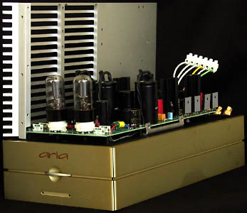

That is on my short list of things to do tomorrow. I’ve checked the gold tone caps on the power rail and they seam to be with in 20% of the 15000uf
And your right about how nasty and dirty it is
The blown fuse is on the - power rail
I have one other amp that I’ll pull the top off and use it for comparison on testing anything I can reach
The first pic show one of the gold tone caps, am I right to say that the board looks burnt?
That cap tasted ok
Thanks for the help guys. Much appreciated
