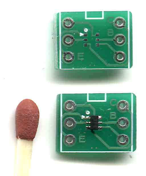

BS847BS is everything except for extremely low noise and extremely matched. As an input transistor it's suitable for almost everything expect for MC preamps. This type is very price worthy. If you can solder it, test it! But beware, nothing for a newbeginner in soldering. Check my picture and compare the size.
The transistor has the same body as SOT23 but with 6 pins.
