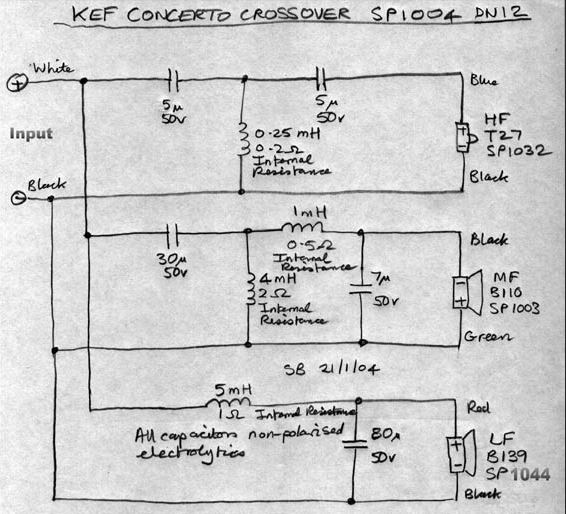

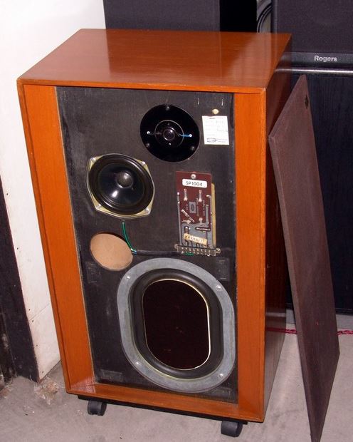

The below KEF Concerto stuff should look familiar. Hope it helps. 😎
Edit: You are on it, Don! LOL

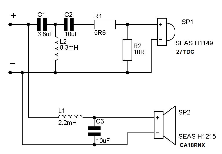

If I have an old cabinet with old and worn-out drivers, I usually measure the bass cutout and volume and wonder if I can fit modern drivers. 😀
Maybe something like the Troels Gravesen Classic three way could be done in a biggish box:
3-Way Classic
I suspect the SEAS CA18RNX might be too small, but George Krilov has some nice designs:
DIY loudspeaker "OPTIMA" - YouTube
See, diyaudio has only your imagination as it's limit! 😎

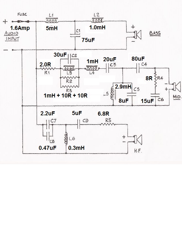

Here's the crossover schematic for the B&W DM2 version II speaker.
Hope it helps.
Thanks for that, I will use it to try and understand the different crossover in my DM2s and to renew the capacitors which I should be able to find on the Falcon Acoustics site.
