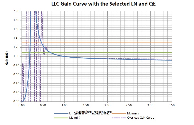

also attached is ss from calculated llc gain curve that i dont know how to interpret but think that it wont work over 60-70kHz.

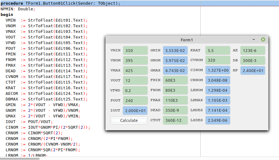

I'm using Linux but it is available cross platform and I'm sure what I wrote will be happy to compile under Windows if you want a play. Green is input numbers. Blue is calculated outputs.
You might also want to play with my roundwire calculator. That's done under Delphi(4). Hopefully still works under Windows. Works out AC/DC wire resistances based on Dowells curves.
In both cases I might have to hold your hand a bit so you can get some idea as to how my warped mind was thinking. There is no rational thinking just a set of processes I would run through to arrive at an end result.
As I say unlike yourself I don't build things but if I were to approach something like this I would be setting up a model in LTSpice and extracting relevant, hopefully meaningful, numbers from the simulations before actually producing a 'real' thing. I would hope to end up with a full, ideal, convertor model that demonstrates regulation and protection loops
I'd be happy to play if you want.

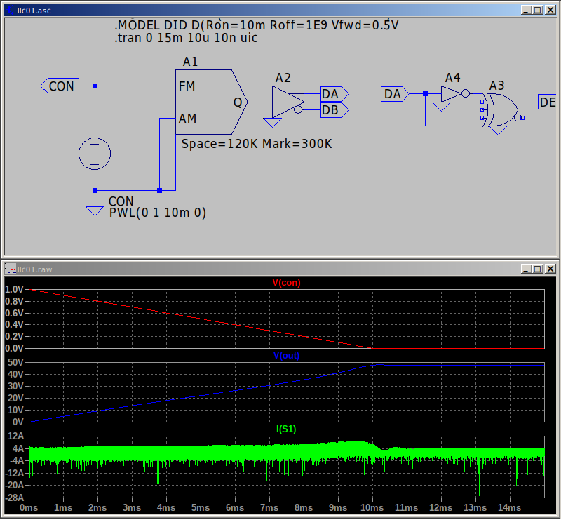

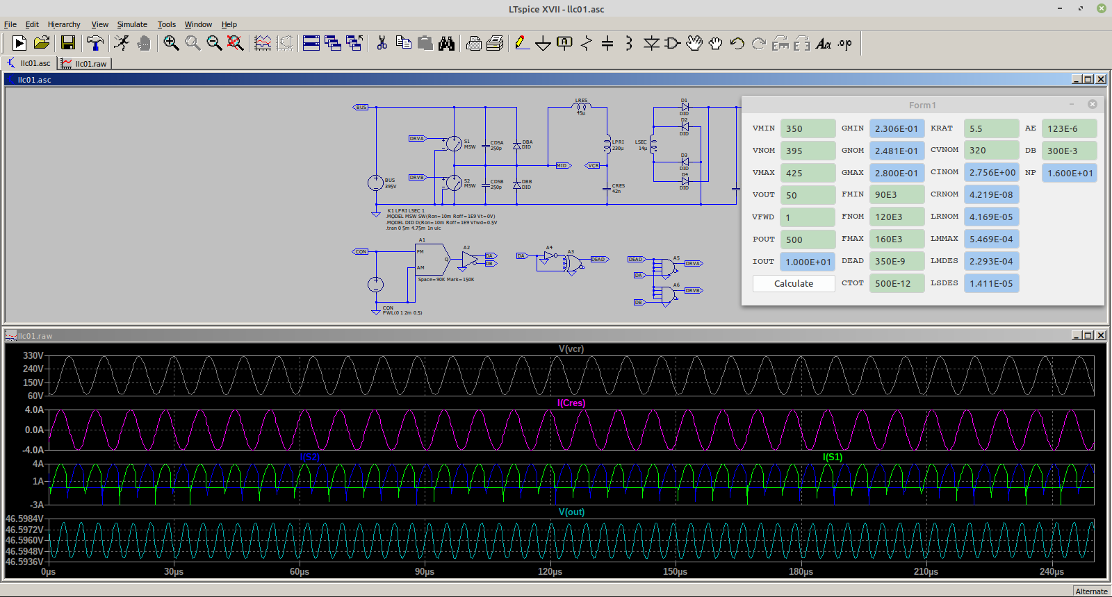

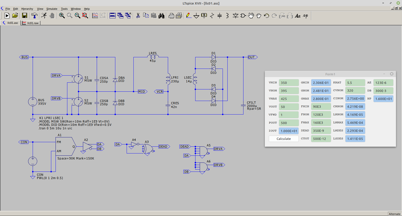

Just for the giggles here we go. 500W according to your design suggestion but I set 5.5 as the 'ratio'. Apparently, making things up as I go along, that one affects peak/average things elsewhere and things get out of hand if you ask to much.
Likely completely bricks itself on start up but when things have settled down peak voltage across Cres is about 320V and RMS current through Cres is about 2.8A so it appears to agree with the application note.

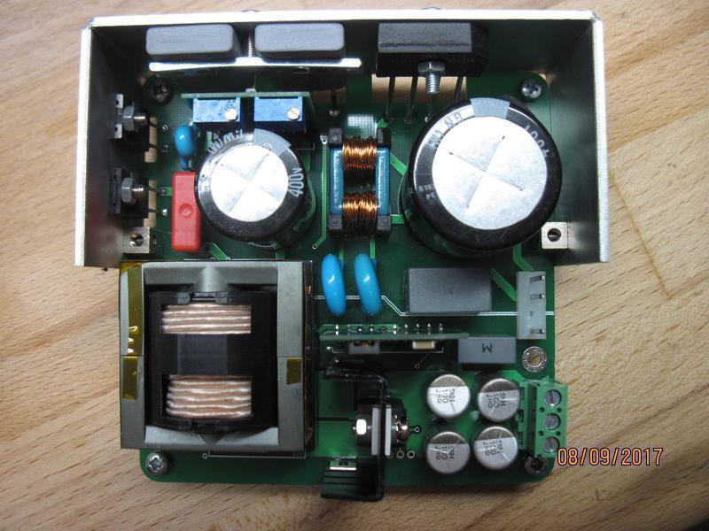

The fotograph shows my working 400W LLC prototype with hand wound xformer on 100x100mm pcb

Another issue is secondary rectification. With dc currents above 1~2 amps the diodes need heat sinks. And these quickly grow with increasing current demand. For a compact design the synchronous rectifier is your choice. Besides the improved efficiency voltage stability of unregulated LLC is superior, i.e. there is no voltage overshoot at light load you will observe with diodes.
The unregulated LLC may be considered the direct replacement for the conventional unregulated toroidal mains transformer supply with similar 100/120Hz output ripple but superior output impedance yielding good stability of DC output. Here the bulk capacitor that determines output ripple resides on the primary side, i.e. there is no point using extra high capacitances on the secondary side.

That's the model. Notice that I have set the Modulator to run from 90KHz to 150KHz. This is the design operating range for regulation. Whilst I ramped CON down from 1V to 0.5V, 150KHz to 120KHz in the actual design Fmax will likely be higher... 300KHz?
It's not there to put you off. It's there to play with and blow up on your computer. When it stops doing that you have a bit more confidence in the design.

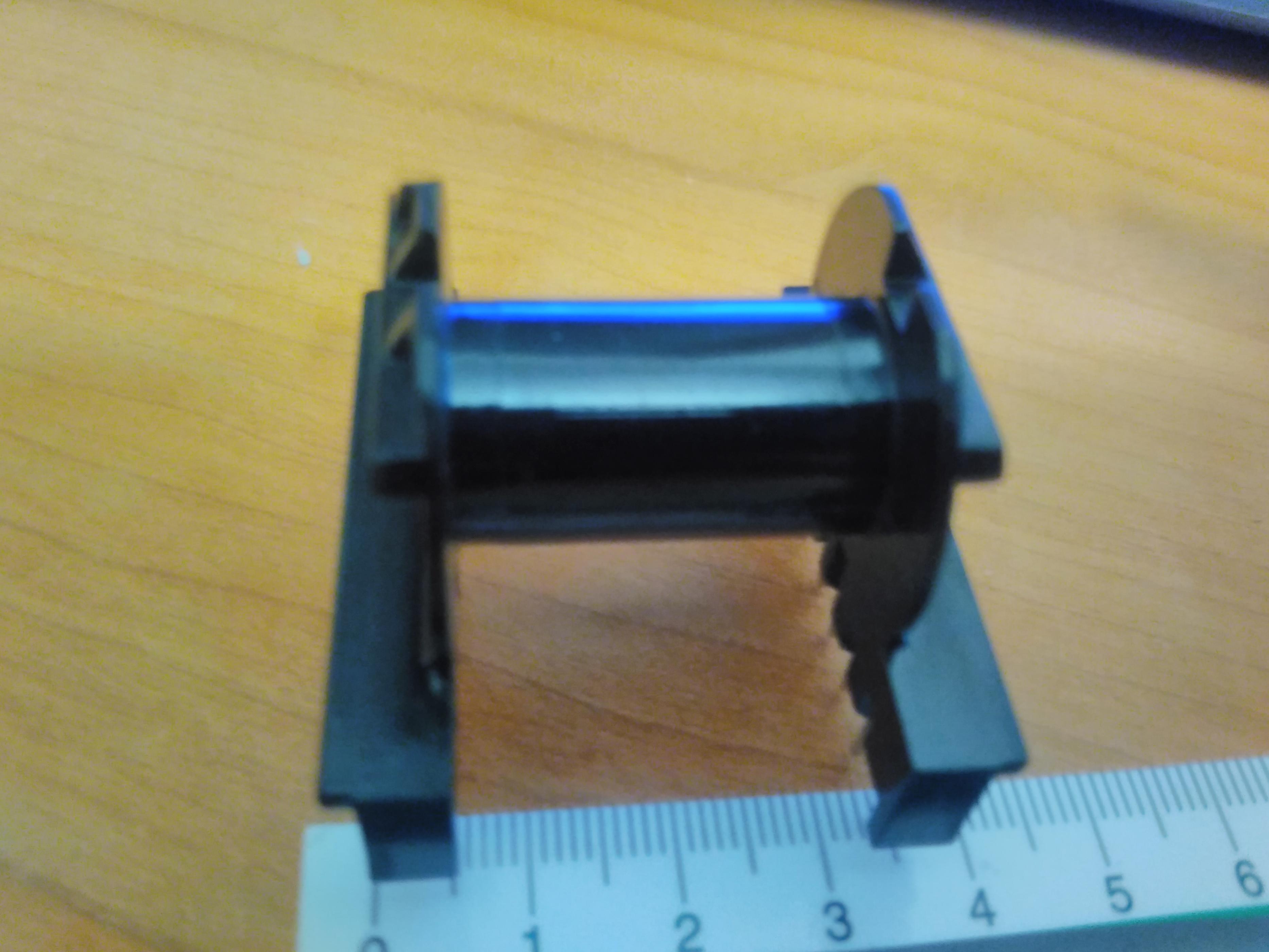

bobbin from wurth arrived yesterday, now to calculate how fat wire and stuff, this is prooving to be whole rack full of cans of worms, but it is fun..
if You could forgive me i dont understand half of stuff you say as i am not native english speaker, and am new to this stuff. thanks anyway.

It looks like you have an ETD39 bobbin. Page 31 give the thermal resistance of a fully wound core as being 16C/W assuming convection cooling. Pick an ambient of 40C and allow a maximum operating temperature of 100C. that gives you a total allowable dissipation of about 3.75W. Assign half to the core and half to the windings or 1.9W each. Ideally that will partition as 0.95W primary and 0.95W secondary.
You will have to look at the properties for the material you are using for the core and the core itself.
https://www.tdk-electronics.tdk.com/download/528882/71e02c7b9384de1331b3f625ce4b2123/pdf-n87.pdf
https://www.tdk-electronics.tdk.com/inf/80/db/fer/etd_39_20_13.pdf
Ve is 11500E-9 m^3 and you've allowed 1.9W so your Pv is 165kW. The relative core losses versus frequency graph in the materials properties, bottom of page 5), suggests you can run to 100mT @ 120KHz for about 165kW. The graph is for peak flux, single quadrant operation. You can double that, any convertor, as long as you do not hit the saturation limit for the material. So your number is 200mT.
Plug that in the calculator to find your minimum primary turns. Take the square root of the ratio of Lmag and Lsec to work out the secondary turns.
For the bobbin take off 3mm either side of your bobbin for insulation/isolation and 6mil, three layers of tape, from the height for insulation and divide what's left in area terms by two. You will be operating the primary and secondary at the same current densities so they will be occupying the same area. Multiply that by 0.7 because you will be using round wire or round rope. NPmin was given by the calculator so divide that into the last one and that will give you the approximate area of your conductor.
Then iterate through with that roundwire calculator to find the best compromise for Rac/Rdc. The calculator will factor in how much insulation robs you of area, assume heavy insulation even if you are using litz. Apparently you target an Rac/Rdc of about 1.4 as a point of not much improvement. Once you are about there check the I squared losses for the windings based on the numbers provided by the model.
Then you iterate again... and again over power and nominal operating frequency. If it does not want to play, very likely, then your core is too small. If it looks too easy your core is too big. If it is just about right then it might work.
