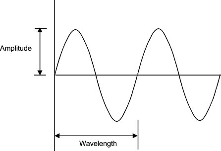

If you display a sine wave on an oscilloscope you will see a familiar wavy line. This is a graphical representation of a voltage. The voltage goes up and down with monotonous regularity. In fact we call it monotonic. It's got just one tone in it.
If you change the shape of the sinewave (distort it), even just the tiniest bit, although the picture on the oscilloscope shows just one (or a few) cycles, the change is repeated identically on all the cycles for as long as the sinewave lasts.
So that little change occurs at least once for each cycle of the original sinewave. In fact, in order to create a regular small change (distortion) in a sinewave it's necessary to add to it a second (and maybe 3rd, 4th, 5th...) sinewave of twice, three times, four times the frequency (and so on).

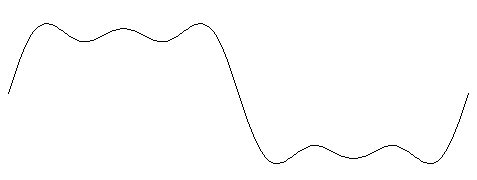

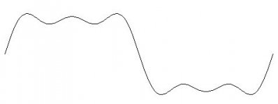

Here's a sinewave with quite large amounts of third and fifth harmonics added to it. Or to put it another way, quite a lot of distortion.
Any conceivable shape of distorted sinewave can be produced by the addition of harmonics.
This is how distortion of a sinewave (a single note) causes other harmonically related notes, or overtones, to be added to the original note, and why they occur at multiples of the original frequency.
