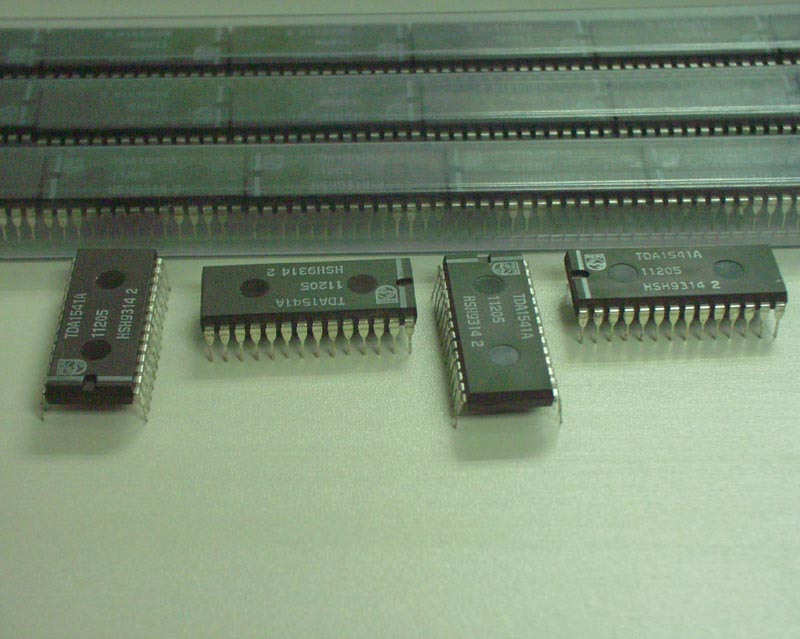

When was TDA1541A last made? (except the 97 lots)
If we don't count the 1997 re-run, when did Philips actually stop producing TDA1541A?
I saw some as follows:
TDA1541A
11205
HSH9314 2
(see photo attached)
Is this real? the date code of 93 seems fairly late.
Also, someone mentioned that as the manufacture method got more mature, the late production of the TDA1541A were somewhat better than the early ones, if so the 1993 should be pretty good, right? 😀
I think it was around 1993/94 that production stopped, production of 1 bit DAC chips had already started. Strange thing is that I've seen SAA7220P/B younger than that !?!?
AFAIK only the non-A versions had true quality problems in the first years they were produced ( this was around 1985/86 ).

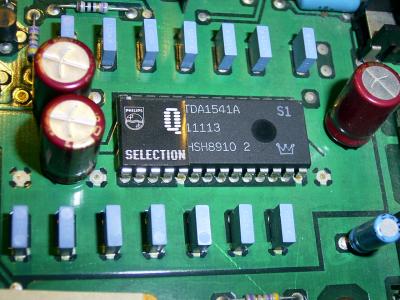

The early chip best was single crown. R1,N1.The best was Q grade which was directly sell to japan. Accuphase was order this chips.Pls see the photos.

But Taiwan made had S2 Double crown grade. There was not white line on the left & philips logo only.
