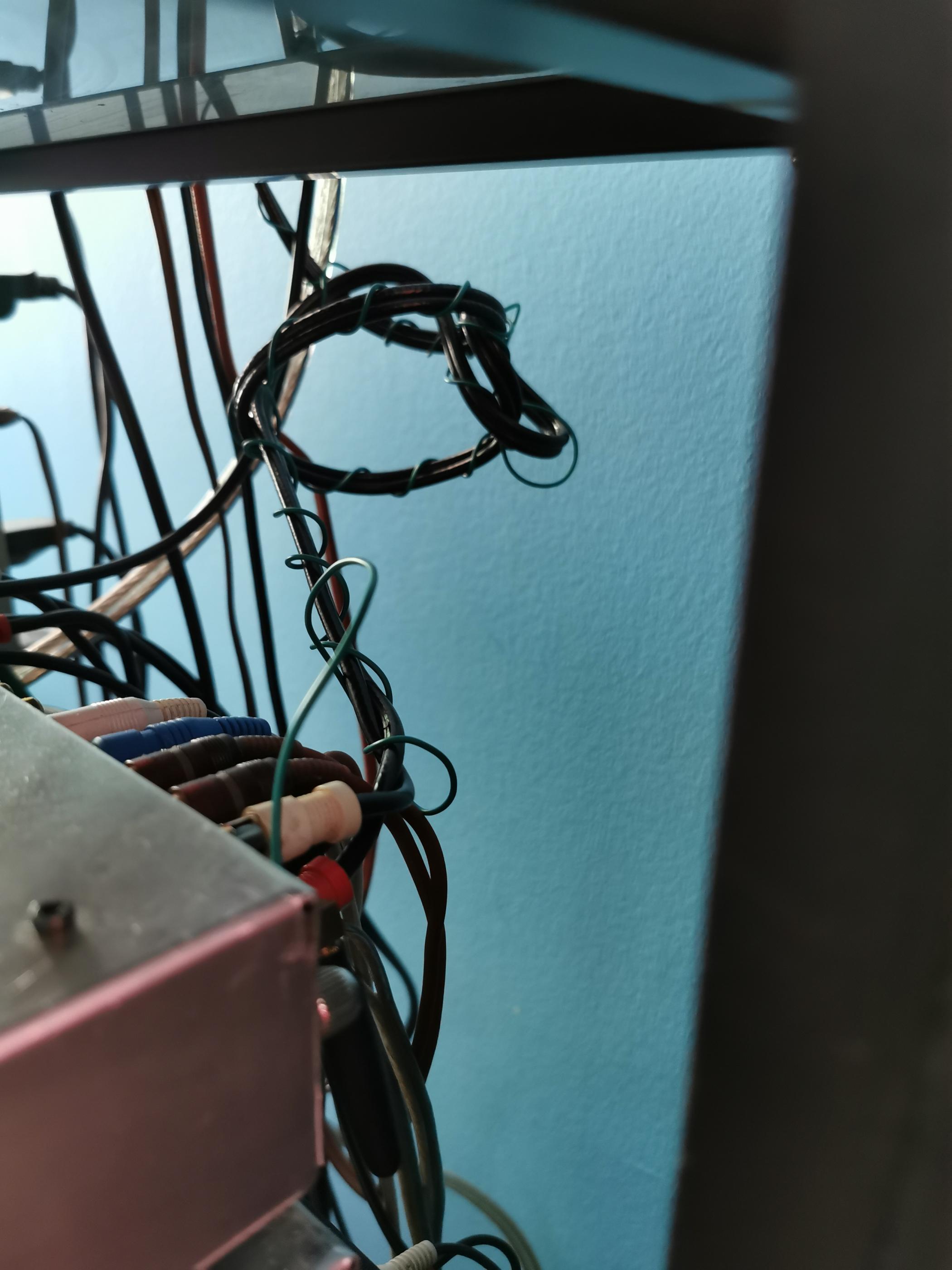

Are you saying this was the first thing you tried?Yup... 120Hz hum even though the amplifier is powered by switching supplies... A simple knot fixed most of it...

Accidentally picking up broadcast VHF is not too difficult, although also not too difficult to filter it away. What is difficult to do accidentally is to slope detect it. Something in your system must have been resonating near 98.1MHz - maybe a cable?
It only happened with "Westinghouse" Japanese 12SN7 tubes... USA or Canadian GE or RCA tubes (seemingly the same construction, but grey plates instead of black) didn't do it.

Maybe a slight difference in valve capacitance meant that the other valves tuned to a different station? Parasitic oscillation? Alternatively, maybe you were hearing some residual AM on the carrier.kodabmx said:It only happened with "Westinghouse" Japanese 12SN7 tubes... USA or Canadian GE or RCA tubes (seemingly the same construction, but grey plates instead of black) didn't do it.
Any number of things really, but my construction technique has vastly improved from those days. I didn't even use shielded wire from the RCA to the grid... (Neither did my commercial "Belcor" receiver though).
Speaking of shielded wire... You only connect the shield/ground at one end, yes? I connect it only at the RCA end of the link.
If the knot is actually solving the problem, then the problem is due to quite high frequency RF. However, more likely that the knot is a coincidence.
You need a signal and a return to complete a circuit. One way to do that is to connect the RCA outer conductor to chassis, and connect signal ground of PC board to chassis at some point, and that completes the circuit. It also makes a big loop and the shield (connected at only one end) does next to nothing because return current does not pass through the shield. Alternatively, isolate* the RCA from the chassis and run a shielded cable with shield connected at both ends, which completes the circuit, reduces loop area, and makes the shield much more effective.
*but with a small cap from RCA outer connector to chassis to make a shorter path to ground for very high frequency noise.
