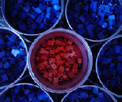

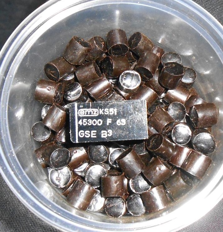

But have you tried hard enough, some candy colors are not in the front window display, and not as clearly visible.
(as are other dark consumables, e.g. liquorice root "drop")

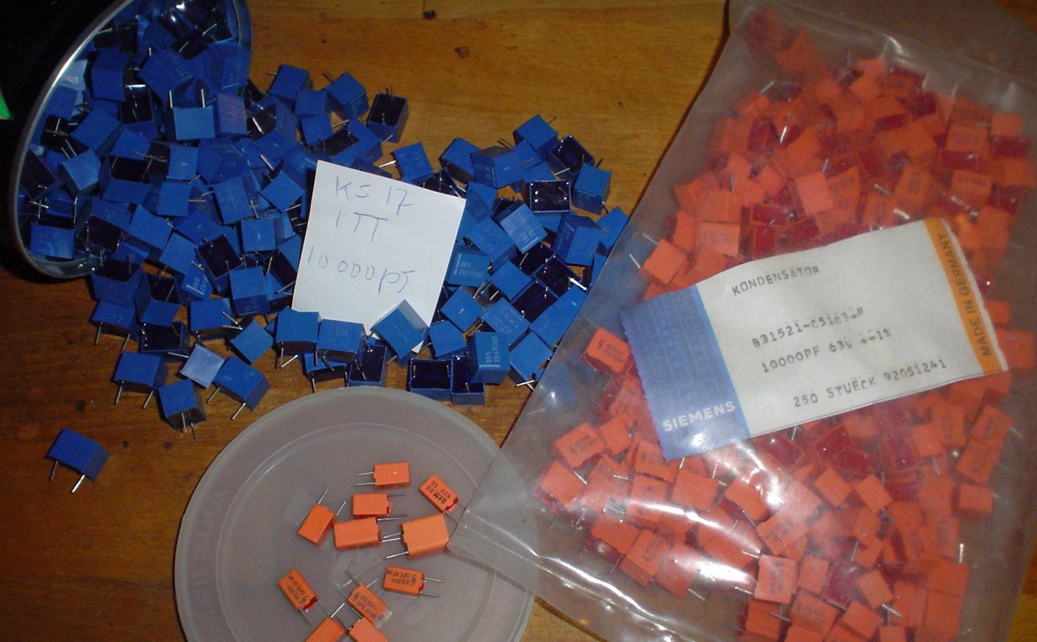

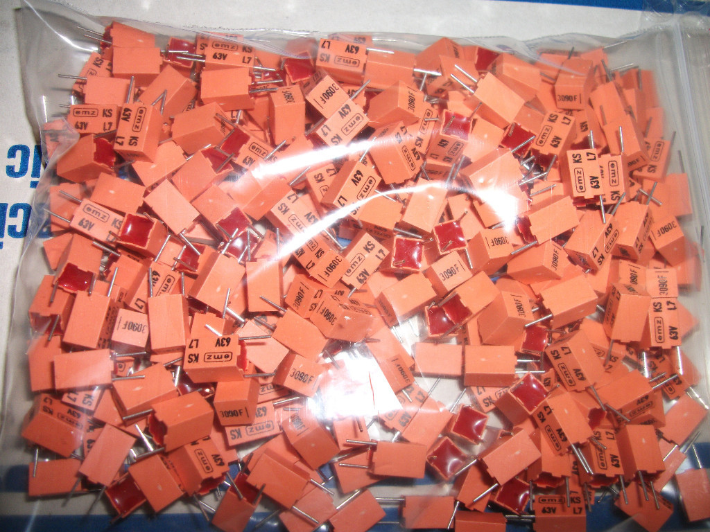

(every worthwhile foil cap, resistors, clad boards, rectifiers, JFETs, power Vertical Junction FETs, Lateral MOSFETs, connectors, chassis, heatsinks, transformers, coils, and every kind of exotic/esoteric mounting item. Just the KS parts amount to 15k total)
