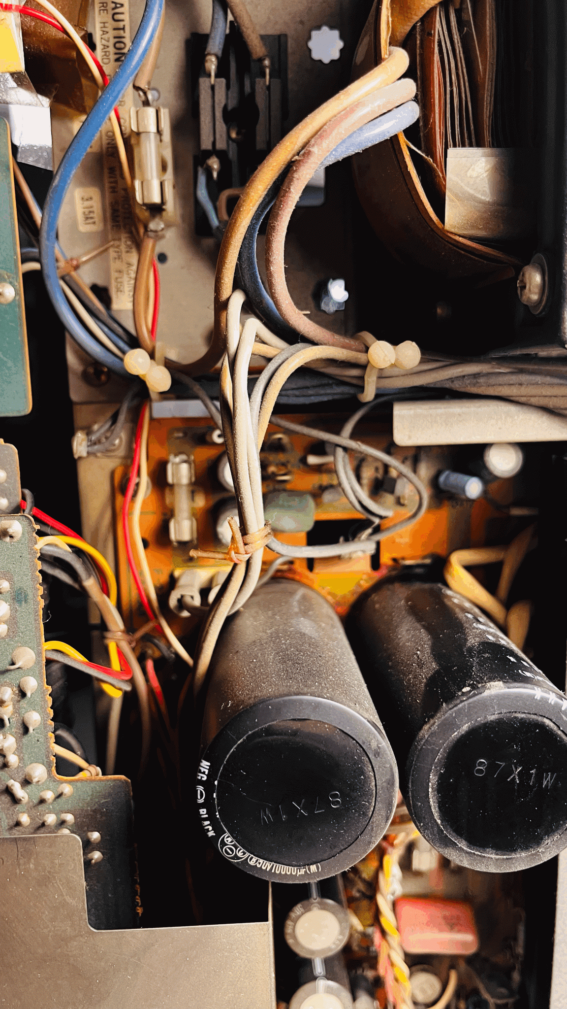

Hi
I have an AU-317 in what appears to be "not too bad" shape.
I got it for free from a friend and I am considering using it as a project to learn abit more about electronics and soldering and such (I have a friend who knows what he is doing who will help me)
The amp sounds ok to my ears but it has - what I would think is - a low AC hum. It is quite audible to me when no sources are playing.
It appears to be unaffected by volume pot or any other controls. My friend says that it might always have been there (he has had it 25years+)

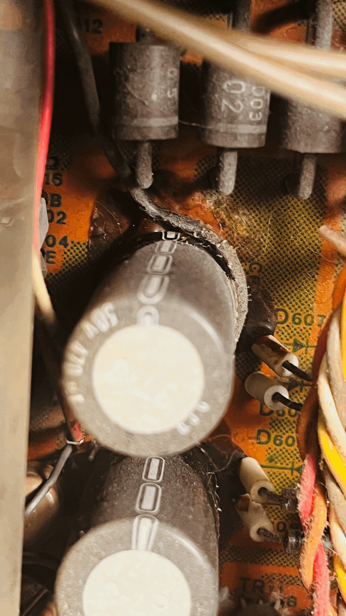

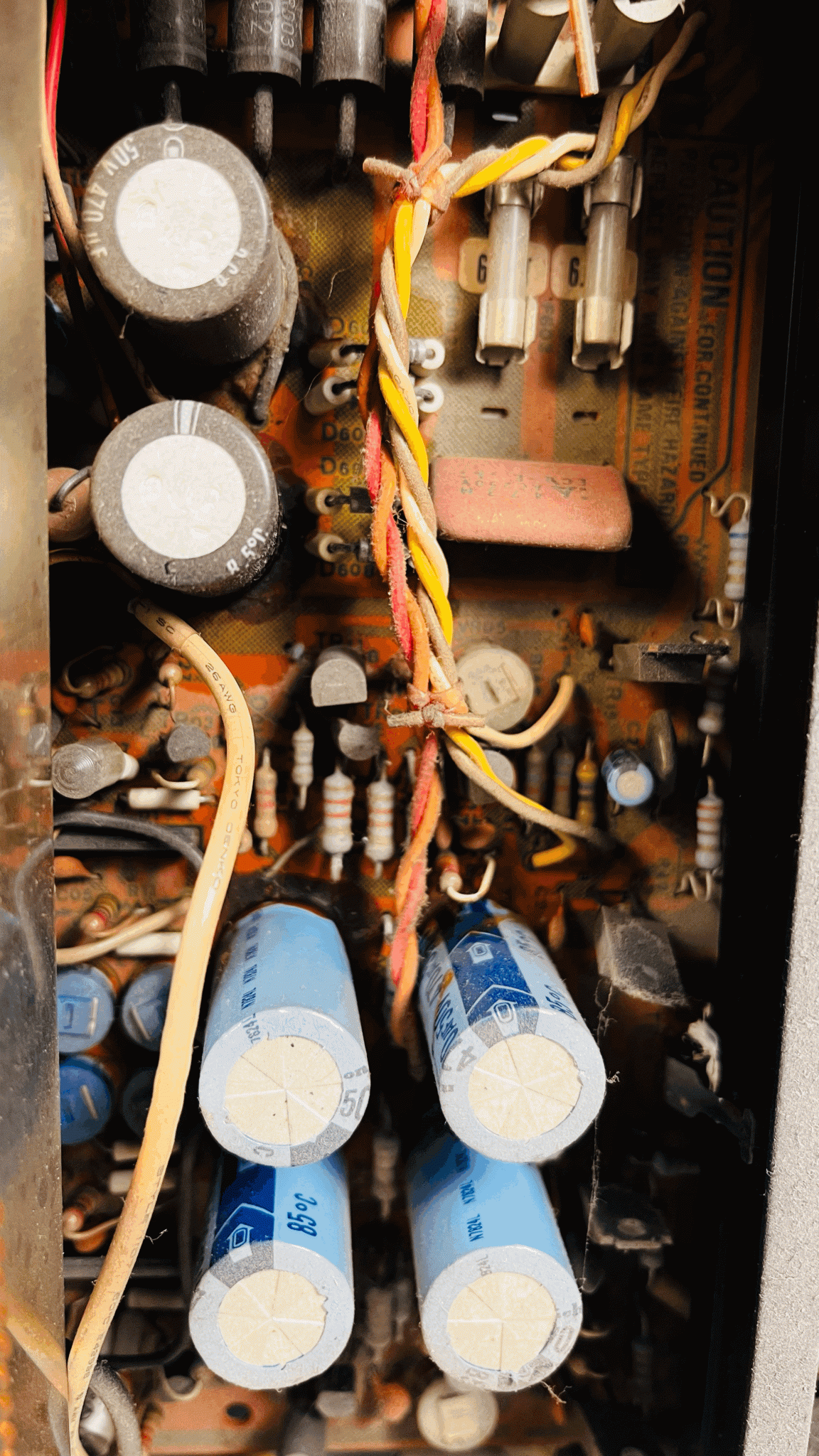

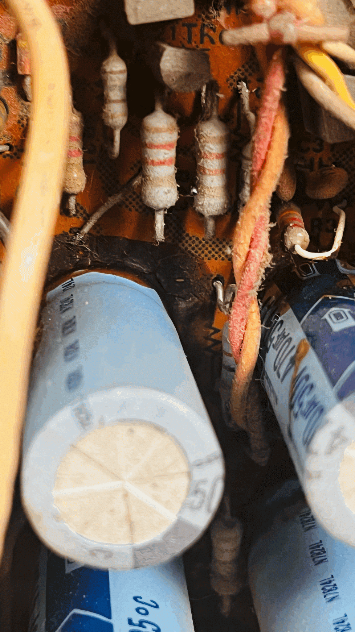

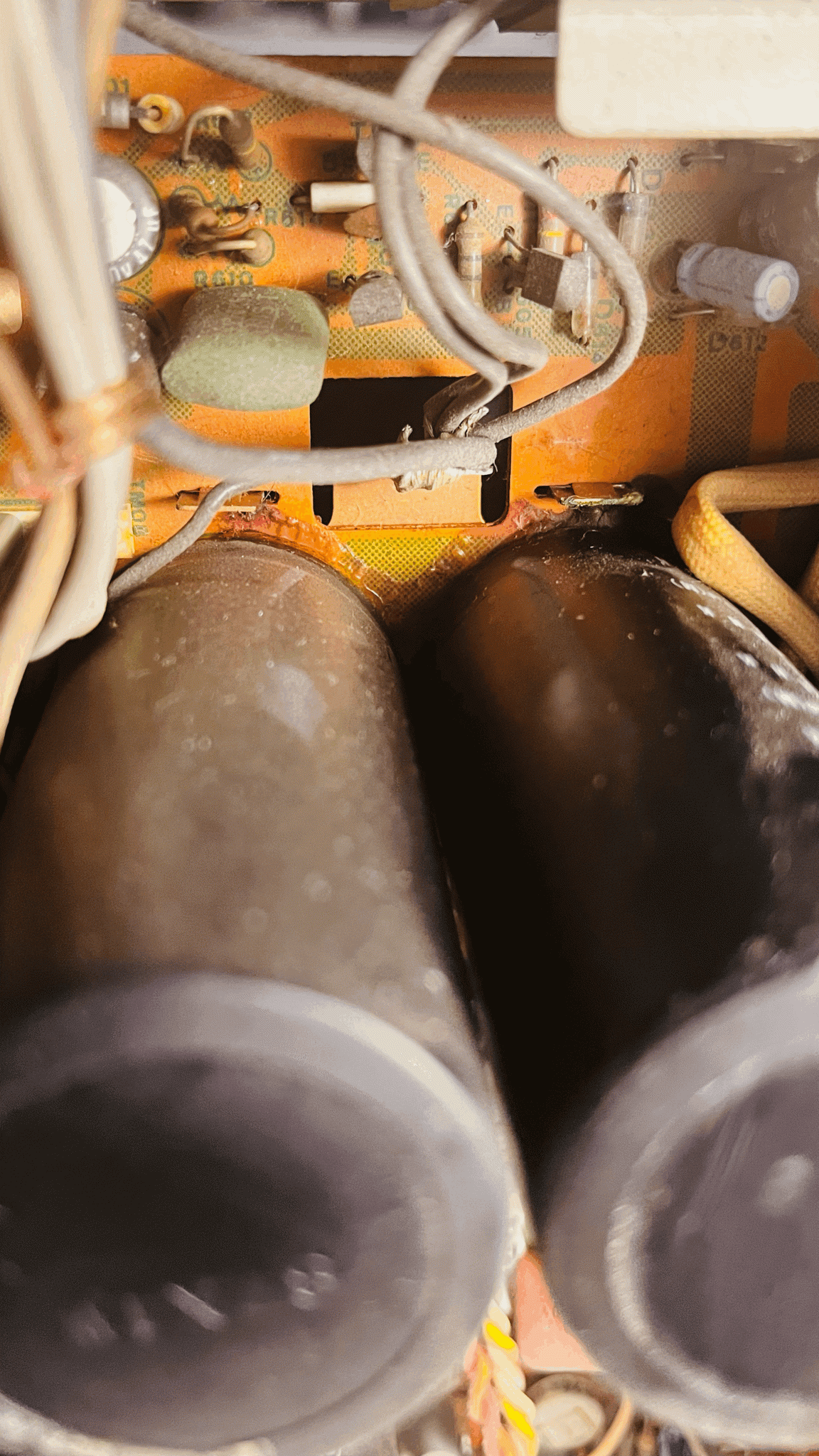

Upon visual inspection, the 2 largest caps and the 6 smaller ones (470µF) looks leaky.
However, the noise goes away when I disconnect the power-stage from the pre-stage by removing the pre/power jumper, leading me to question if replacing the big leaky caps will solve the problem as those caps appear to belong to the power-stage?
Any thoughts on what the culprit might be or if my line of thought is sound at all? 🙂

Is this a series II?
https://www.hifiengine.com/manual_library/sansui/au-317.shtml
Replacing the leaky 10,000uF capacitors in the power amplifier section is fine, but the 470uF in the preamp section
may be the cause of the hum. There are also a few more in the preamp supply, 100uF and 47uF.
Probably they should all be replaced. Work on them one pair at a time. First the 470uF, then the 10,000uF,
and then the rest.
If possible, first practice soldering and desoldering on a junk board to get some practice and to avoid damaging the amp.

I think it is a mk1
I will practice a bit as we have vast amounts of old electronics laying around.
I have access to high-quality tools for measuring outputs as well, I am in the process of scouring this forum to soak up the needed knowledge 🙂

Looking at a capacitor and suspecting it to be "leaky' is unprofessional nonsense.
Unless there is a definite fluid leakage around the cap, not glue which in some cases is used to anchor heavy caps.
There is no visible way to suspect a bad cap unless it has blown itself up. - a clearly opened-up popped top or seal. (not the damn "bulged top cap" that people seem to worry about. - that is normal plastic deformity.
So PLEASE people, listen to me, and use a meter or signal tracer to troubleshoot a hum problem in electronics.
It's the ONLY positive way to locate an issue.
And if you don't have test equipment, you should not even go about guessing things, that's something a fool would do.

That is not a leaky capacitor. That is the glue used by the manufacturer to hold down the capacitor. You might want to remove the glue since they will already or eventually become corrosive.Upon visual inspection, the 2 largest caps and the 6 smaller ones (470µF) looks leaky.
